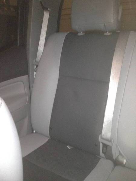

    So many options, but going with the storm trooper motif, I opted for: two tone, gray and black with black contrast stitching, center butt and lower back panels are perforated, upper and forward bottom panels are not. Upper fronts have white TRD logo stitched on top of black thread for offset. They are heated (just in time for winter and wow, does that high setting get hot!) I liked the switches in the console vs. on the side of the seats.

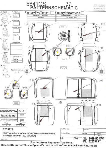

    I've included an image of the pattern schematic from Katzin. There are two differences from prior years:
    1) Rear headrests fold down so there is a hole for the arm latch to protrude
    2) The rear seats have all "straight" lines - no curves like on the original material (see pics).
    Note that I had them leave the arm rests existing gray vinyl...my opinion, no need to pay to have that turned to black vinyl. (Note: 2012 models have vinyl, not cloth armrests). Also, the center console was left the factory black vinyl also. They have already received their first Lexol cleaning and conditioning!

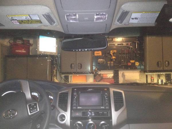

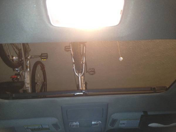

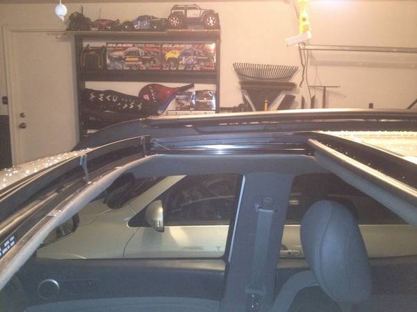

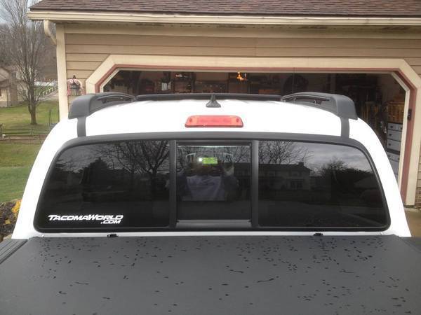

    Again, much research, debated between Inalfa and Webasto. Inalfa won because they had the special trim ring for the Tacoma ribbed roof. Inalfa 925 (largest you can get) which also has auto close feature. It was also important to me to have the control switch mounted on the lower left in one of the blanks. I ordered an extension ribbon cable for them to be able to run down the A pillar. The 2012 has the bluetooth mic in the upper console so the switch could not be mounted there (easily, that is). Plus, I think it looks more factory on the dash. They took the Inalfa piece off that goes around the switch so it fits nicely in the blank. My other big must was to not cut up the sunglasses console. I saw soo many pics of other members that got theirs chopped and it did not look good to me....not factory. As you can see in the pics, the console was moved up 1.5" and stayed intact. Installer also wrapped the new headliner beautifully around it...he did an amazing job! He said he spent a lot of extra time to make it right. The roof is not pushed back further to make this fit as I've read many complain about moving the roof back to save the sunglass console. I look up and I see out!
    There is all new headliner and of course, it dropped the ceiling height down. I'm 6'4" and have no issues rubbing against my head. The installer was over an hour from my house and I drove home with it open all the way in 30 degree weather....it was awesome...of course my seat heater was on:)
    It has been raining all week and dry as a bone inside. 3 year warranty and I'll go back once per year for free cleaning and lubrication.

    Through the roof!
    I'm sorry...that had to hurt...but you are so much nicer now:)
    The full upper console, intact
    Installer did an awesome job wrapping headliner around upper console

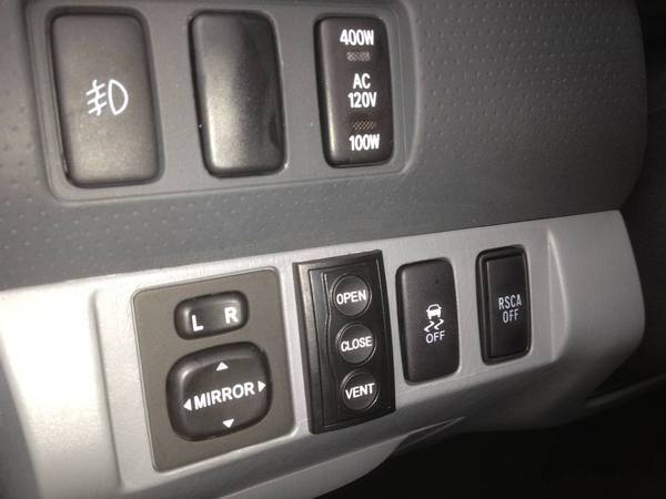

    Switch looks as factory as possible now on the dash

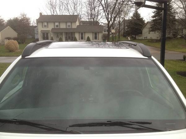

    Quick outside pics in vented position...its raining!
    Finally, the schematic that shows the straight "lines" I mentioned above, not the curves in the seams as in the original fabric. At first, I thought this was a mixup but they confirmed this is for the TRD seats.
