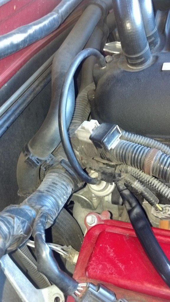

    Quote, "Alright, here is the picture of how to run the vacuum line, when doing the OEM FPR MOD.
    Thank you dpartinvr4 for the picture. [​IMG]
    If you also have a boost gauge, you Tee into that line for the boost gauge. "
    You already have the factory FPR. Unless you want to upgrade to a better one, the factory will hold you over until then. Put a vacuum cap on the barb fitting that is on the intake tube. Then do a the vacuum line just like in the picture.
    However, wait until you have an AFR gauge installed, just so that you can get some visual data of before and after the mod. :thumbsup:

    All the FPR mod is for is to increase the effective output of the injectors, due to increased fuel pressure, from a industry stadard starting point of 43.5 psi. It is also a form of extremely simple mechanical tuning.
    An aftermarket EMS will not negate the FPR mod. My truck is tuned and running with it. (Well....when it has an engine.)
    So is Toon714. So is Murderface on XRU, as well as a whole world of tuners with other vehicles. Just implementing forms of tuning that are commin everywhere else, except on the Tacoma. Odd that.
    Boost gauge is more of a tool to tell you if you have a vacuum leak/over-boost/under-boost(slipping belt) or other strange anomaly. Quite handy for more than just seeing boost. :thumbsup:

    Next plan is to do the FPR mod and install the URD y-pipe. Anything else I can do for more ponies, what about that nst lower pulley, that give me much HP?

    I sure will. I think I will try the vacuum line only option first...see how well that works.

    y-pipe is here. I will put it on Wednesday, Thursday my wideband afr gauge and boost gauge will be here so looks like Friday is the day for the next dyno. Only changes will be the URD y-pipe and fpr mod. Tor, any guesses on what she will do?
