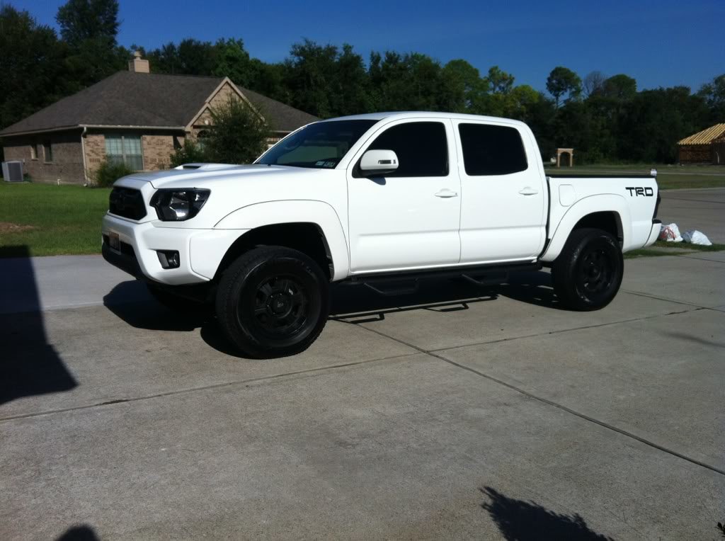

    After some searching, I'm still unsure whether or not the 2012 TRD DC Sports come with TSB rear springs or not. The reason I ask is because I just installed Bilstein 5100's up front set at 1.75" with stock coils, and it is nose high by about .25". Is this TSB or no?

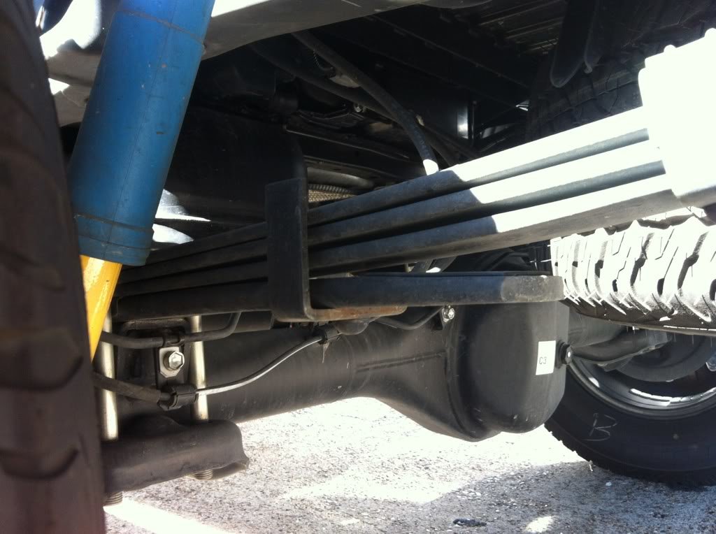

    Here's what it looks like

    Alright. Well I'm slightly hesitant about lifting the rear 1.5" with AAL's because I don't want to make my 265/70/17's look small.

    I have the 2013 and it looks just like the OP rear springs. 4 instead of the 3.

    Well, are they even considered "TSB" springs if they come from the factory with 4 leafs?

    No , TSB springs is just a way of describing them here on TW
    FWIW , Canadian Tacomas have come stock with the 4 leaf " TSB " springs since '07
    Guess Toyota figures we use our trucks as trucks and you guys want a car ride and zero load capacity
