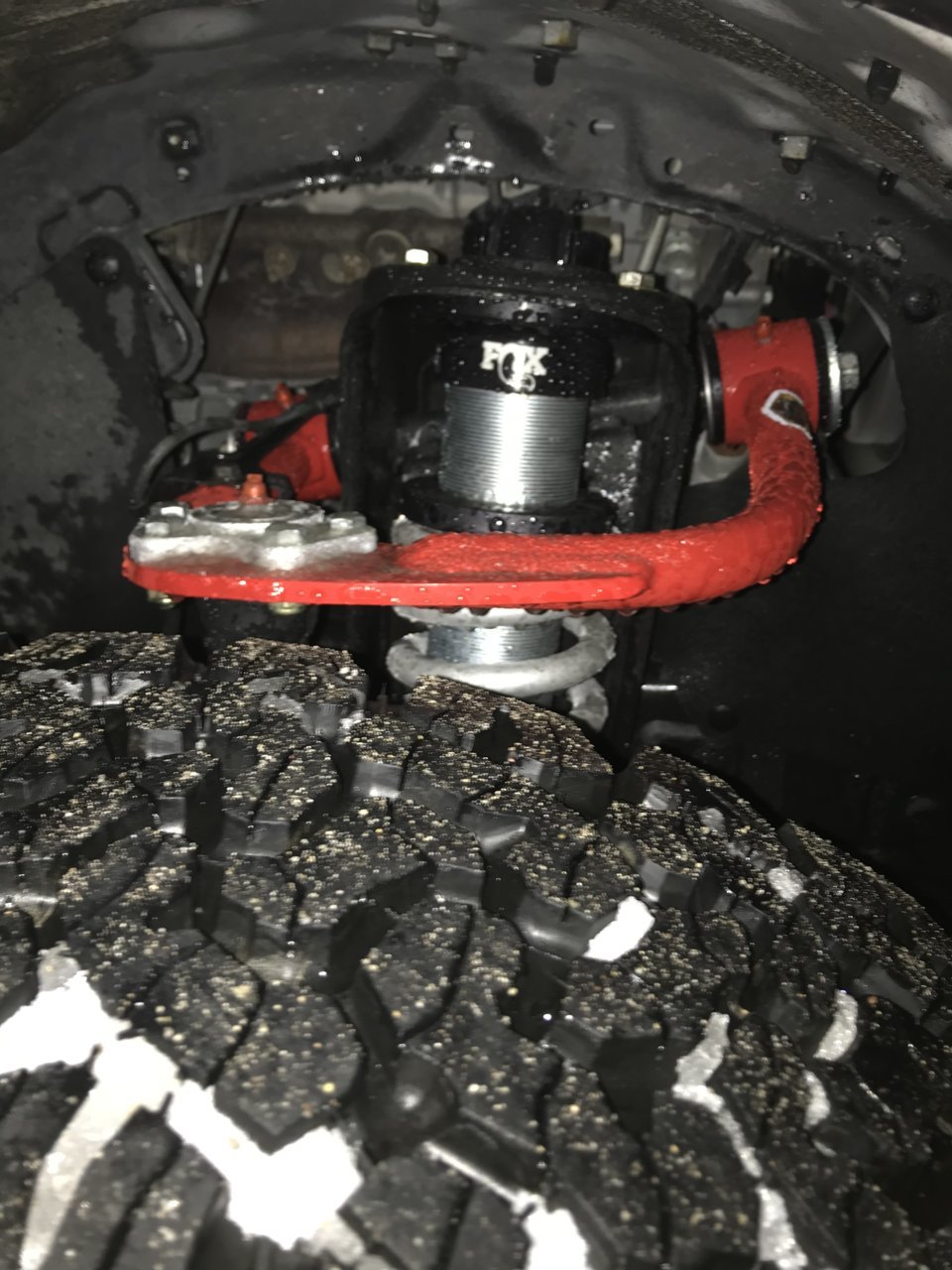

    #215498
    12
    Johnny
    2014 Tacoma doublecab 4x4
    Stock
    C1E0A3AC-7992-41A4-A839-F60673F7B1AC.jpg DF3A09D6-63FB-48E6-A58E-16E758FC3C82.jpg
    Fox 2.5 ext travel co (at preset 2”)
    Fox 2.0 rear resi
    Icon AAL
    JBA off-road UCA’s
    Diff and CB drop
    265/70/17’s
    Have the needle bushing from ECGS but not yet installed.
    Rides great!
    If I was to do it all over again, I’d get a full leaf pack replacement. She squats with any added weight. Something I’ll consider changing later on.

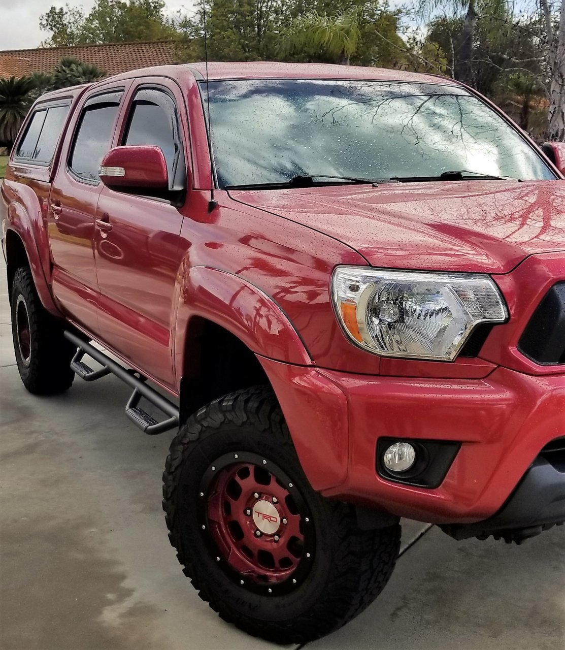

    NayNay94
    NayNay94 Active Member
    Dec 14, 2018
    #275811
    25
    Nathan
    2013 Tacoma TRD TX PRO Baja Series
    I recommend getting color matched mirrors with turn signals on your baja

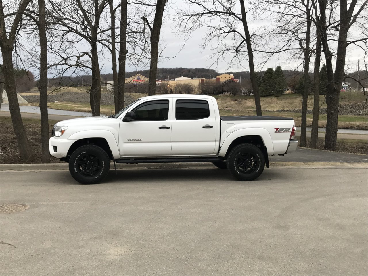

    Armyhater458
    Armyhater458 [OP] Well-Known Member
    Sep 11, 2017
    #229702
    2,596
    Clarion, PA
    2012 TX Pro
    OME 887, LR UCA, Dakar 095 (medium duty), Dick Cepek Extreme Country 255/85/16

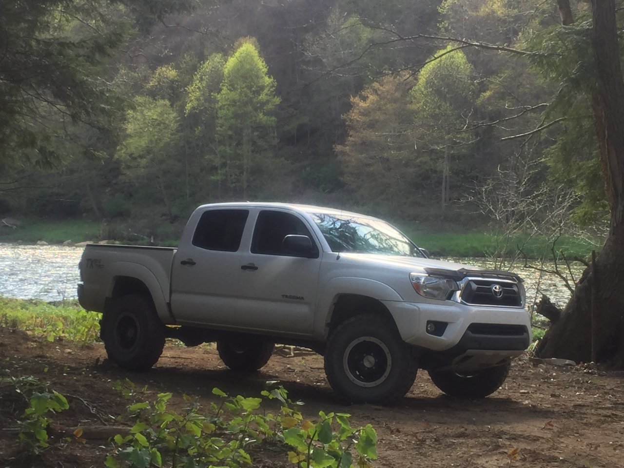

    Figured I would try to get a more updated picture of the truck in here. I don't have a good on that gets the whole truck though. I also have to get the front fenders and snorkle added yet.

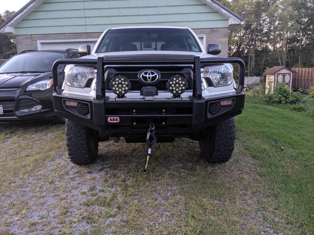

    Armyhater458
    Sep 11, 2017
    #229702
    2,596
    Clarion, PA
    2012 TX Pro
    After almost a year since I started this thread I figured I should put a more updated pic on.

    Aardvark13
    Aardvark13 Sultan of Squeeze, Wizzard of Slide
    Mar 23, 2018
    #248164
    1,275
    Byl
    Knoxville
    2014 DCSB OR
    Aardvark4x4 Built for Go
    So whats the story with that swing out HC bumper? did you build it yourself? I like the simplicity of replacing the tailgate and having an all in one solution. Any idea how much it weighs by itself?
    Sep 11, 2017
    #229702
    2,596
    Clarion, PA
    2012 TX Pro
    I bought it used off a guy. There was a local that built 5 or so that have been passed around the east coast. It is a great design that works well. It has its drawbacks though, a ton of weight on the rear axle, which compromised my Dakars. You need 5 ft to open the tailgate. Biggest issue is my kayaks, I can't just put the tailgate down and load them up anymore. I like it, but it has some negatives I didn't consider. IDK what it weighs, but with the spare I would estimate 2-300 lbs. There is a fold down table and cb antenna mount built in.
    The bumper is separate, and made by @Skell at KORE 4x4.
