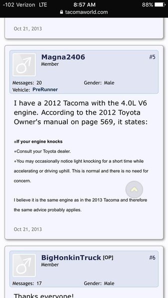

    "Inside, the 1GR uses a "taper-squish" combustion chamber design with matching pistons to improve anti-knocking and engine performance, while also improving intake and fuel efficiency."
    From Wikipedia : Toyota GR engine.
    So they are admitting it does knock a little. For those who were wondering or worried.

    I saw that the manual indicates some knocking to occur and I suppose Toyota would call this normal. Just concerned/curious is all.
