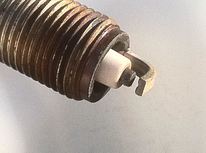

    For giggles, figured I'd add some hard data. I pulled the plugs on my truck and checked the gap. The gap was within the .039-.043 range specified. Also, the condition of the plugs was excellent (16,000 miles on them) as seen in the attached photo. I was looking for evidence of knock or detonation and could find none. No oil/fuel on the plugs (except a bit on #6 threads, which I read here is typical for the 1GR-FE).
    Kinda starting to wonder if it really is spark knock or something else. Found a way to test that, I think. There's a 76 station not far from me that still sells 100 octane pump gas. At $8/gal, I won't be running a full tank, but I'll go half a tank and see what happens.
