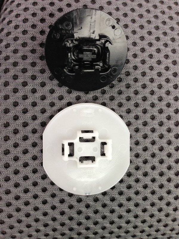

    Hi guys,
    I'm "that guy" that went rounds with Scott and WeatherTech about the horrible fit on the passenger side linears (2012 DCSB). I ended up moving the anchor points and now the liners fit like a glove. Here's what I did to get them out and get them moved:
    Removing the little b*stards is the hardest part by far. As with most plastic things installed by the factory they are really only designed to be installed (not removed) but by popping off the door floor trim, removing three carpet staples (which I replaced later) and squeezing the clips on the underside I was able to get both of them off with only limited cussing.
    Once removed I laid the liners in to use as a template for the new locations. I marked the new hole locations with a pen (lightly) then used a utility knife to cut out the approximately 3/4" x 1 1/4" (measure it because I'm not sure) hole that matched the original size. Then move the plugs you just cut out into the original holes and apply some E6000 or Shoegoo to the edges. Since the carpet you're removing is the same size you should be left with little to no unsightly holes in your carpet and in my case the twist-lock floor clips covered most of the old hole location anyway. I'll try to post so pictures I took while dealing with WeatherTech and Scott.
    FYI Scott and WeatherTech were both awesome to deal with and I would hardily recommend Scott and his company to anyone.
