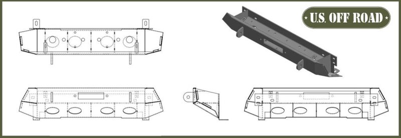

    I slept on this a bit and am going to sit down with CAD on Monday to do an accurate layout with the 4" holes to see if we can locate these to be useful for all of the reasons above.
    Other than that I think we are all in...

    Glad you're looking at doing the holes... it gets hot in Arizona.

    yup, i'm also good with either option! holes or not, doesn't matter to me

    Ok guys, here ya go. We positioned the 4" holes so you could easily get to the front winch mounting holes (the 4" holes are only .100" off vertical CL - see top left image) and still get to the rear holes which have much more vertical clearance internally. I think this will work fine but will know for sure after we have a 'production prototype' in a week or two.
  13. Jun 9, 2014 at 7:35 PM
    #173
    motionridr8
    motionridr8 Well-Known Member
    Dec 21, 2011
    #69183
    511
    Drew
    Greenville, SC
    2012 Tacoma 4x4 DCSB
    5100's/886's/JBA UCAs, ICON RXT Rears, US Offroad Winch Front Bumper, BAMF Rear Bumper, 235/85r16 Skinnies
    Looks great. I'd say we can call the design phase complete!
