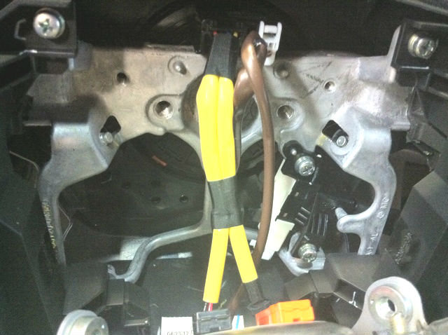

    i just took the airbag off. just two T27 torx drivers (extended ones are handy but theres plenty of room in there)
    i think those of us without controls are hosed. i see some space next to the CC/ horn plug but im not sure theres anything going to it... i think if there was a pre-wire in there for the controls, it would have jumped out at me...

    Ya, would likely be on the left.
    You'd at the least need a new spiral cable, and if the harness is not run through the column, still more work there.

    its hard to see in that photo but there is a location that appears to be open, same width, to the left of the narrow white connector that has the brown wire going to it...
    very true, just adding in wireless RF remote is a cinch.
    adjusted contrast in above picture. location more noticeable..
    edit again...
    if the OE steering controls uses a skinny plug just like the white one... then i think the location for it is the open space next to the white one shown above...
