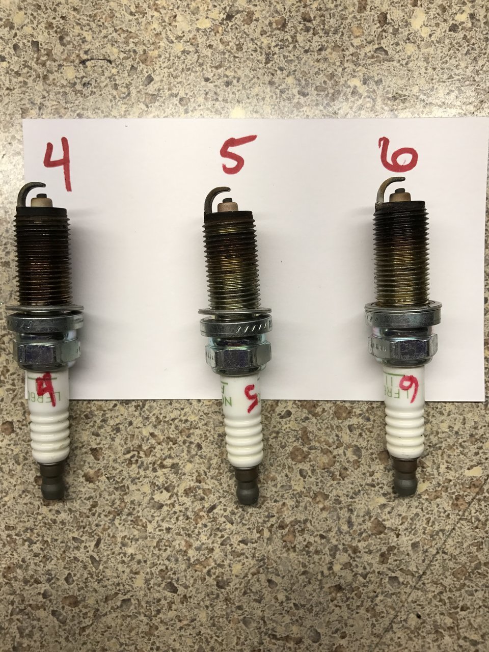

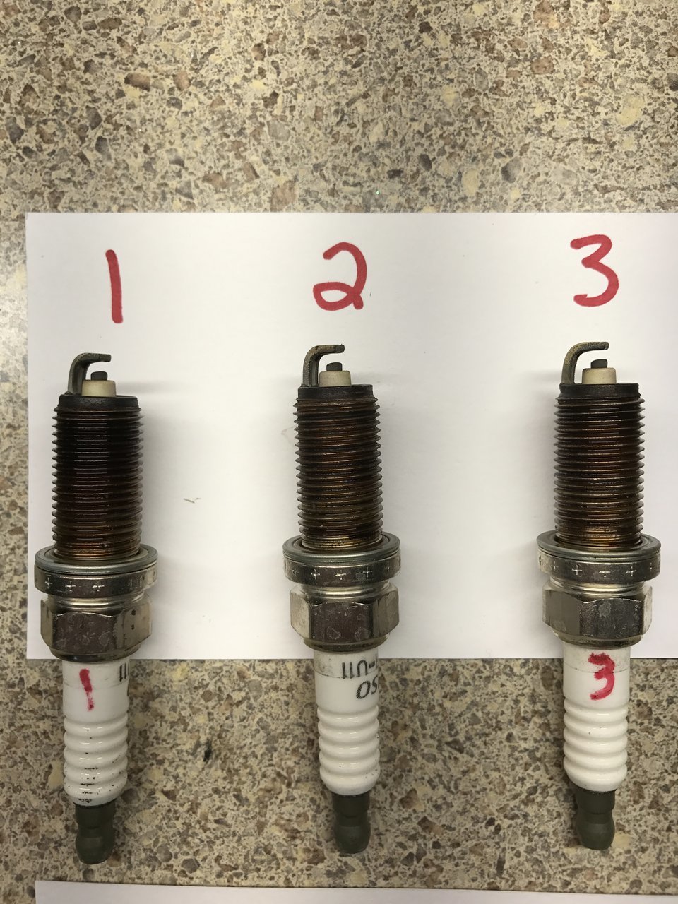

    My new to me truck w/79K miles on the original plugs. I will stay w/OEM Denso & change ~30K miles from here on out. All were >.045".

    '12 DC 4x4 OR
    110% agree.

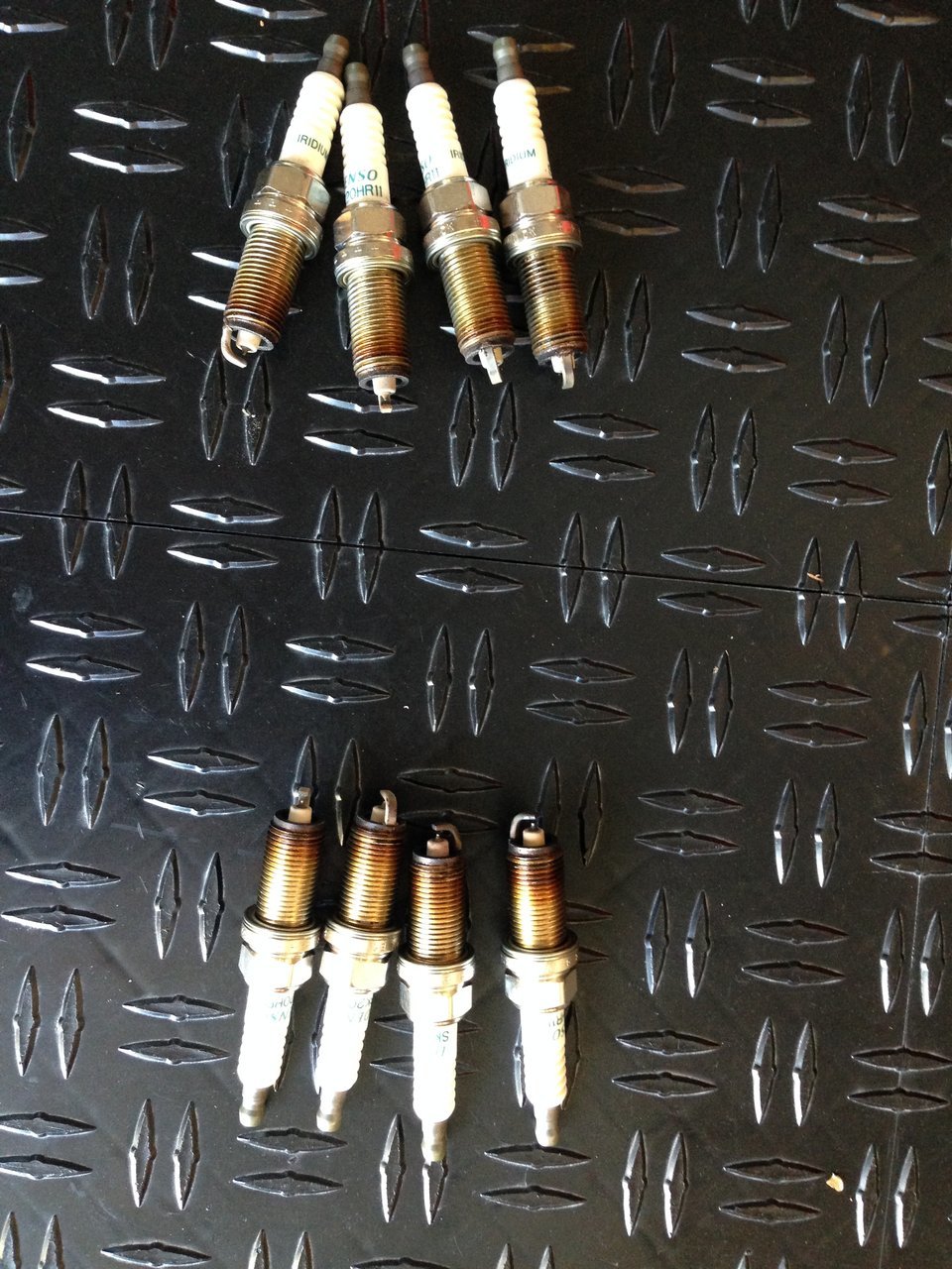

    MolonLabeTaco likes this.
