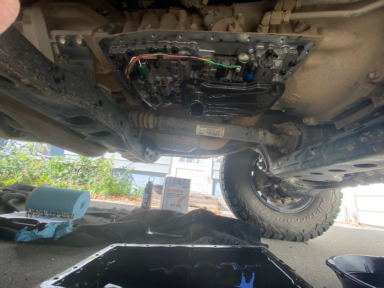

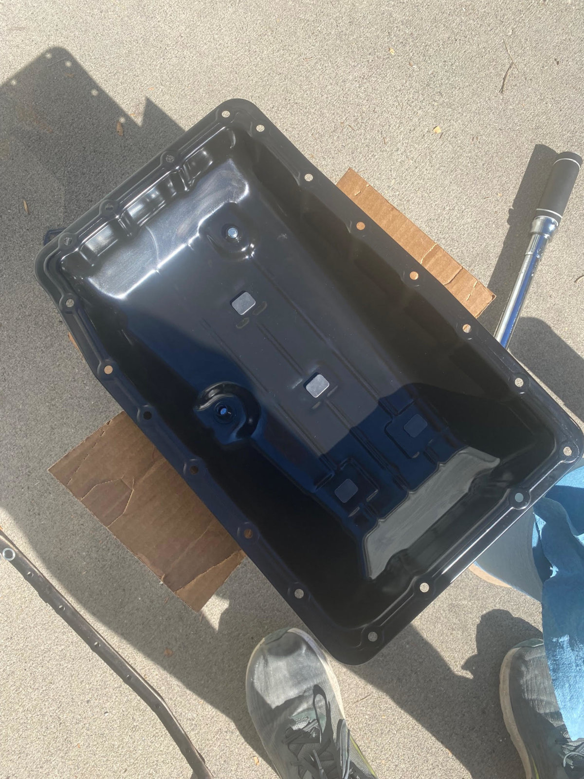

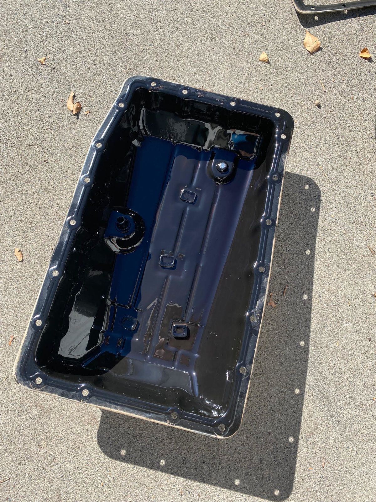

    So I took the pan off yesterday cleaned the filter, new o-ring/gasket, 5qrts new fluid. In the process that 29ft-lbs torque spec on the drain bolt stripped my threads and now the bolt is spinning (I even used a torque wrench!?!?!)
    My big issue is that I’m trying to go to MOAB on Friday… I’ve RTV’d around the washer on the pan prior to putting fluid it as the bolt is tight and not wanting to come out. I’m worried that the drain bolt has the potential to fall out on drain/ruin my trans (is this even possible??).
    Sounds like I have 3 options
    1 - New Pan (shipping times and expense make this hard with my upcoming trip)
    2 – Junk Yard pan locally (I run the risk of getting a damaged pan/pre-stripped bolts)
    3 – Heli-coil in new threads. Is this even possible? Reading the threads it sounds like these bolts have sleeved threads?
    What would you do? Rock the ghetto RTV bolt for the trip or seek alternatives?
    Thanks!!!

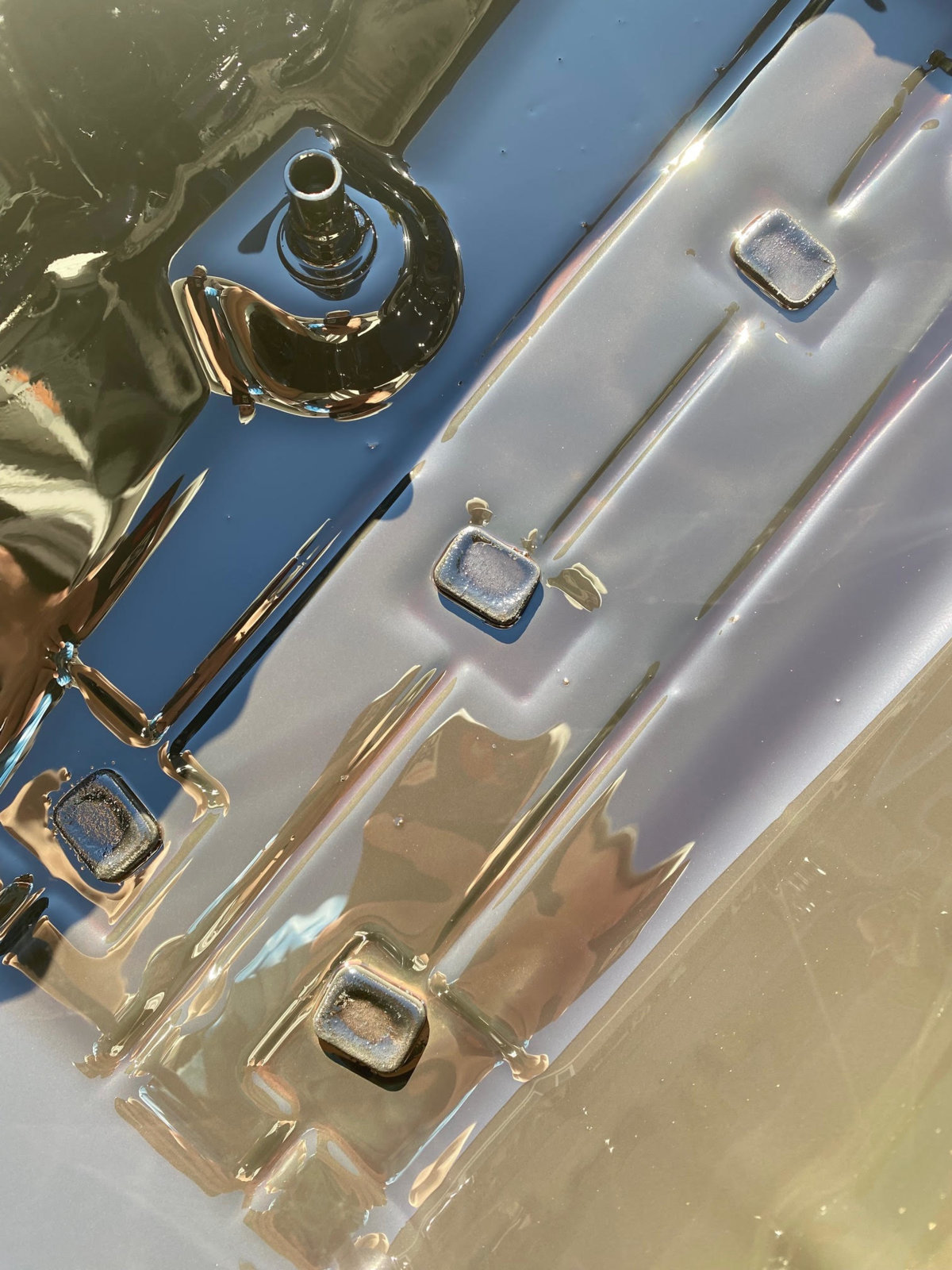

    This is my inner lazy guy speaking but, is there even a possibility that that nut could even fall out and drain AS-IS? The thing isn't leaking and I couldn't get it out even when unscrewing and prying on the back of the bolt with a screw-driver. Sounds like the threads are maybe an inserted sleeve in the pan that's likely spinning as a whole. I'm kinda thinking that this sleeve (if there is one.. just some verbiage I found in the threads) might be impossible to fall out once stripped. Not sure though, hoping someone has experience with this haha
    I totally agree with you Jimmyh, I tightened that drain bolt with a torque wrench with the pan off the car with the threads dry and it still stripped!
