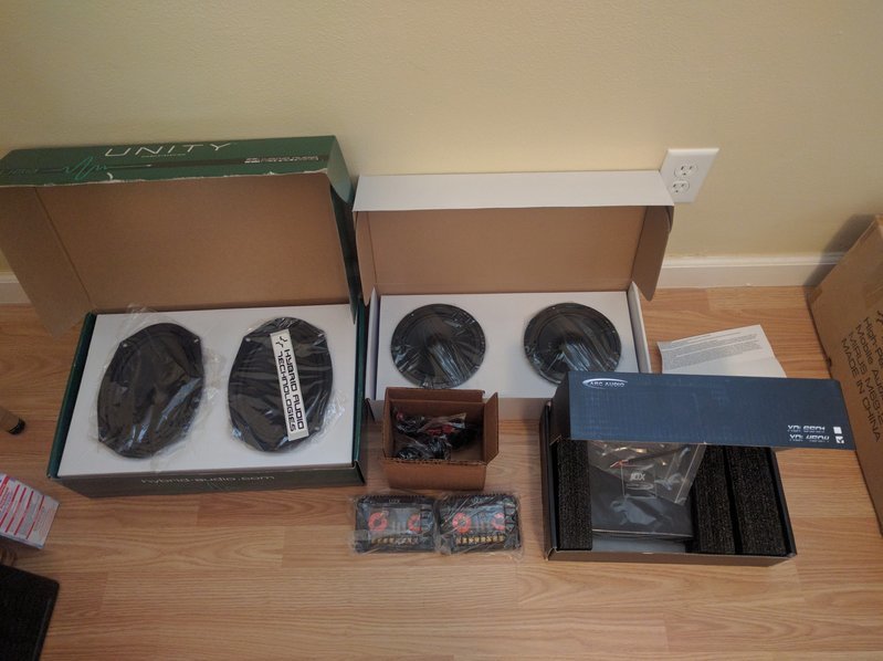

    Got all my goodies in!

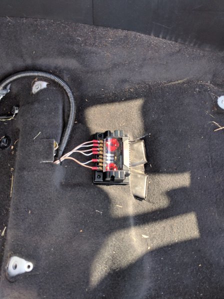

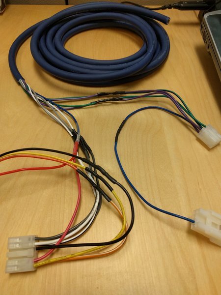

    Soldered up my harness to the Speedwire provided by Marv... notice that in order to use the amp turn-on wire, the two red wires from the harness have to be connected to the blue wire from the Speedwire. I've never used Speedwire before - it's a pretty awesome product.

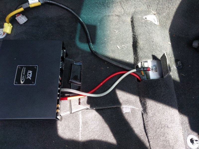

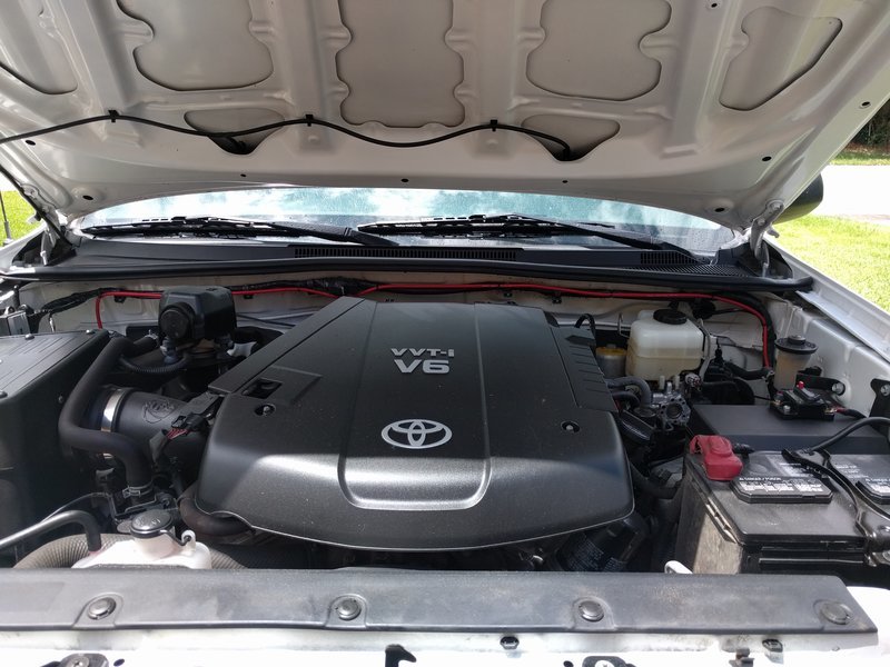

    Decided I wanted to place the amp under the passenger seat... so here's how I got the power wire to the amp... I ran it along the firewall and into a grommet that was there from the factory with nothing going through it. I cut a small hole in it and ran the wire through there.
    Here's the amp placement... just behind the vents under the seat. Per Marv's suggestion I used a 1/2" thick piece of plywood and hot-glued it to the metal under the carpet. Then I used 4 1/2" tall spacers under the amplifier to allow a little airflow from the vents to go under it. I tried 1" tall spacers, but then the amp would hit the seat, so I went back to the 1/2" ones (92825A112 on McMaster).
    I also followed this thread to flip the stabilizer bar under the seat: https://www.tacomaworld.com/threads/extra-room-under-your-passenger-seat-its-easy.278325/
    After that I just screwed the amp into the plywood through the spacers. Ran the ground wire to the bar under the seat... used a Dremel to sand off the paint and expose the bare metal, then used a self-tapping screw w/a terminal lug.

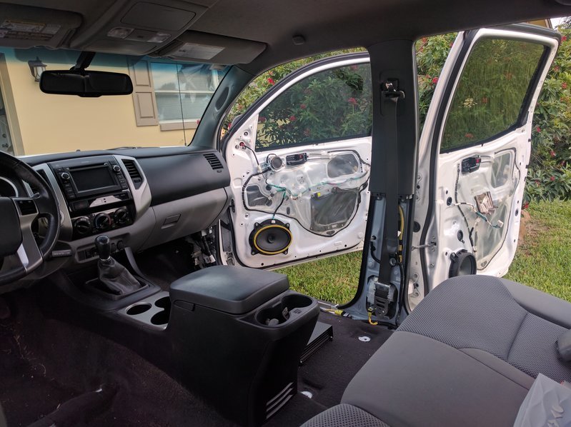

    Interior ripped out:

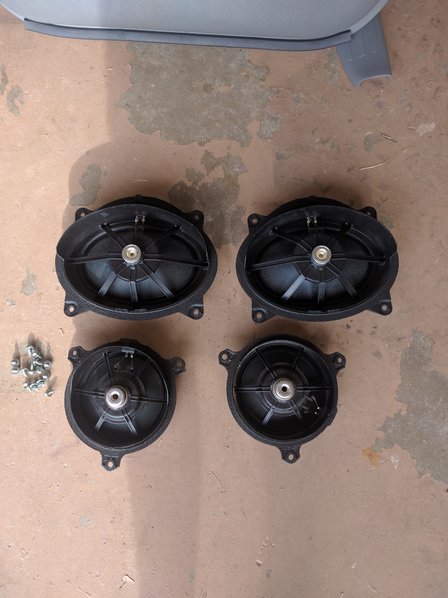

    lol @ stock speakers:

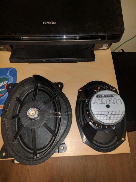

    Comparison between the stock 6x9 and the Unity:

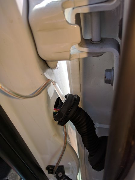

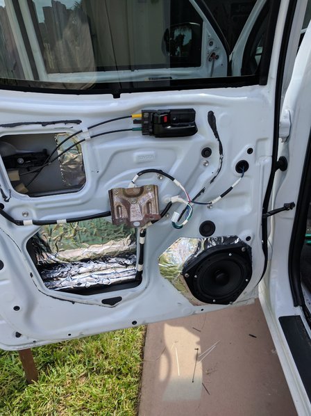

    Came up with a neat trick to run the wire through the door boots. I cut a straw off a bottle of Great Stuff I had laying around... then I inserted the speaker wire into the end of the straw... it was a perfect fit and allowed me to use the straw as a pull-wire. Saved me a ton of time trying to get the speaker wire through the boots... was starting to get pretty frustrated with it until I came up with this... then it was a piece of cake.

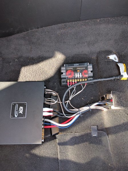

    Final wiring under the passenger seat... I may go back later and throw some wire loom around everything to clean it up a little more - not terrible though.
    Driver side Crossover under seat... just used Velcro to secure the Crossovers to the carpet.

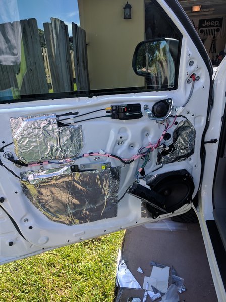

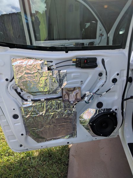

    Threw some RAAMmat on the inner door skins... didn't go crazy but I made an effort.
    RAAMmat on the outer skin. I cut up some foam board and used that to bridge the large holes and to give some backing to the mat... worked out pretty well. Again, didn't go nuts with the sound deadener but I sealed up all the major holes.
