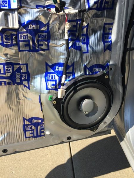

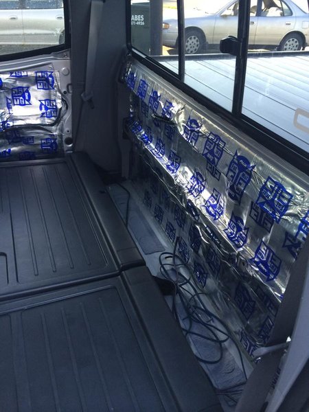

    Got the Fat Mat installed. I didnt realize how much I had left over from my previous truck. I was able to do all 4 doors, the back wall, and still have some left over. Got the speaker wires ran from HU to back wall for the LOC. And I got 1 door re-wired. I ran out of speaker wire and day light, so I will finish tonight. Hopefully i can get some of my box built. It has been raining and water does not fix well with MDF in the bed of my truck! :D

    Looks great! Careful that the additional width of the sound deadening material doesn't require a slightly larger channel cutout in the box- mine still fits but it's pretty tight.

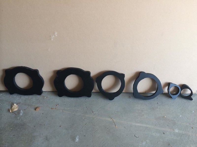

    Got the speaker rings cut, and sprayed with truck bed liner. I had some lying around and seen that other people used the same. Some of the cuts are not the best, but i was using a jigsaw sine my router does nothing but burn bits up on MDF!

    Nice work. I get the time thing, I took a couple days off last week to work on mine and I'm still not done. Though, are you ever really "done?"

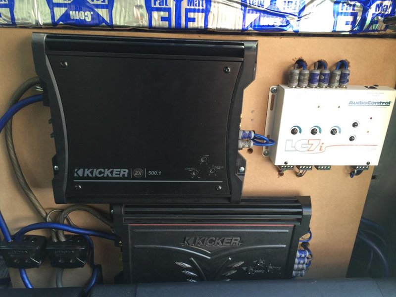

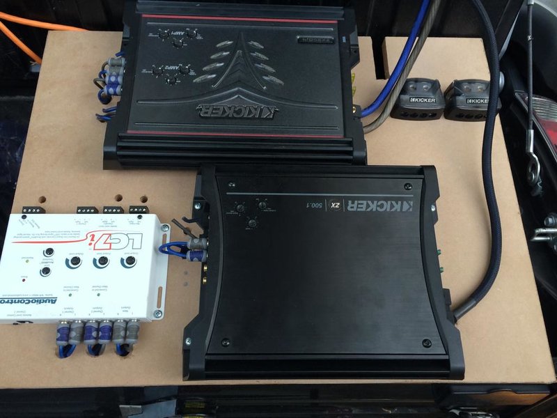

    Got the amp rack cut to fit, amps mounted, and RCAs wired behind. Just realized I didn't run my bass knob wire or the remote turn on.....whoops. Good thing truck is still in pieces.

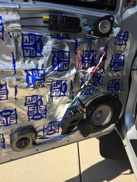

    Finally!!! Got everything wired and hoked up, except for the sub and box....i still need to build that. Everything work on the first try too! After matching the levels on the LC7i, i do hear that hum that people talk about. I really dont notice it right now, especially with the engine running.
    As for the Infinity Kappa....i love them! I know they got some bad reviews about being to tinny and loud, but i really like the way it sounds. The crossovers had either a +0db or -6db. I set it on the -6db and it sounded great. The +0db was very loud and tinny. I have the gain turned up slightly on the amp just to get some extra bass out of the 6.5s.
