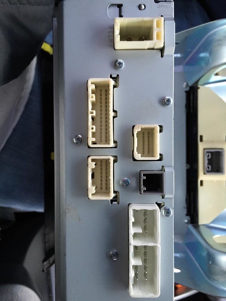

    I installed a 2013 non entune touchscreen radio into my 2012 model radio. I had 3 connectors from the factory harness that would not fit... I believe they are the Bluetooth microhone for hands free phone and the steering wheel remotes. Also the antenna connector is different... Anyone make this switch before? Is there any way to make the above issues work. Any help is appreciated

    B3C0E958-F180-4E3B-9D69-90025F8F5055_zps_9fc9866efbd22368d8ae6643d8704d01accf177f.jpg
    this is the back of my factory 2012 radio

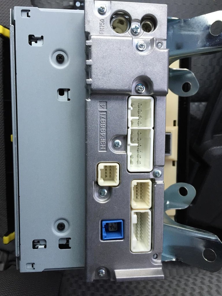

    You will need the 28pin to 20 pin adapter and the blue plug is the Xm antenna

    FEE92B25-A130-4BED-A127-32268E1333AD_zps_92e3996c2547db52513f449f52b9ff8ca522a315.jpg
    this is the back of the new 2013 radio I'm attempting to install

    Update. I ordered the 28 pin to 20 pin harness adapter and the antenna adapter. So everything's taken care of other than the blue Xm plug... Wondering what others did to regain Xm radio

    Finished with the install. I ordered the 20 pin to 28 adapter from dealership for roughly 34 dollars. Then the metra 40lx-21 antenna adapter from local shop for 20 dollars. Right now I have an/fm radio, cd, and Bluetooth audio. Steering wheel controls work fine and usb charge phone. I lost Xm radio and auxiliary jack input. In order to get Xm radio, you'll need to pick up an SL3 tuner and sxv200 from vais technology. Think it runs in the low 300 dollar range for both parts. My subscription was about to run out so not too worried bout losing Xm. The address book and hands free phone is way better than my stock head unit was so its a good trade off. Overall happy with the swap
