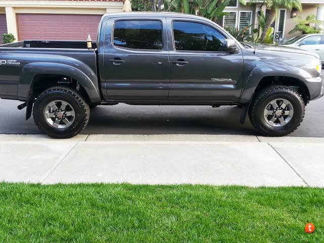

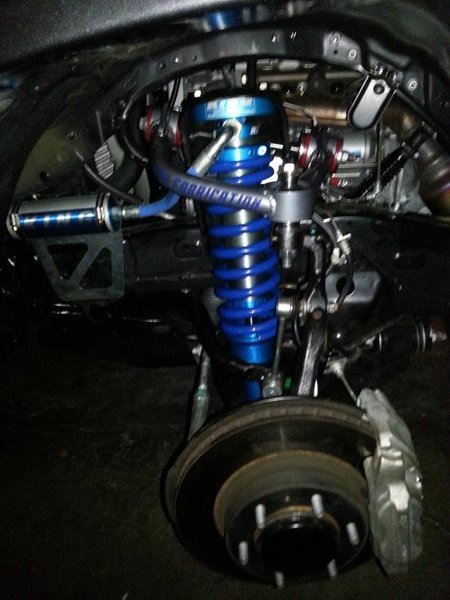

    Got the front done. Coilovers are at factory setting which levels it out with the factory rear. Will put on the rear leaf & shocks when I have some time and adjust the coilovers to level it back out.

    Ahhh, fresh and clean. Let the molestation begin. You are definitely off to a good start. Oh, ya, 285's they'll fit, eventually

    What tires did you go with? Are those 265/75 on there? That's what I'd go with.

    Went with 265/75. 285's just seemed too big.

    Looks sweet I have the same exact suspension setup minus the icon leaf pack

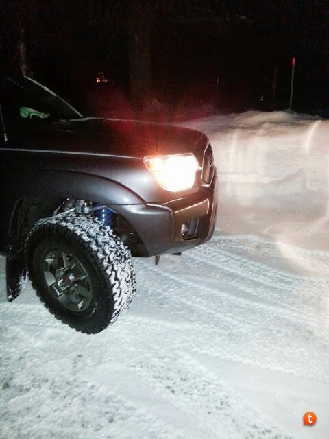

    It rides great, but the coilovers are shit for down travel and I can't even crank them to match the 1.5 lift in the back. I'd go with icon

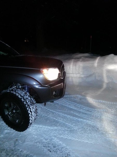

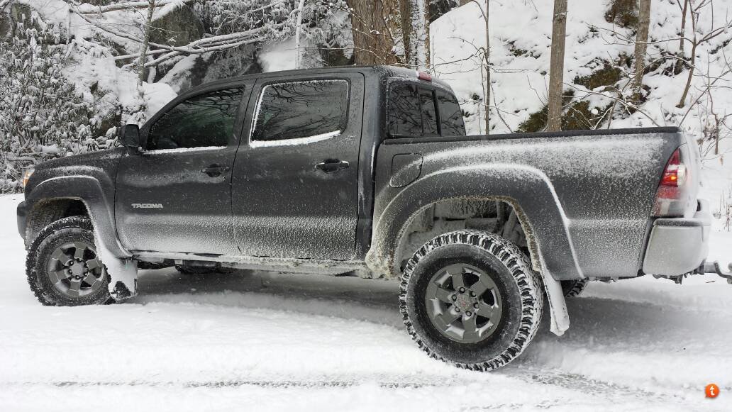

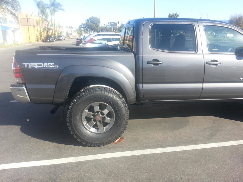

    Sorry for the late reply... I hardly check this out anymore. I adjusted them this morning (7 turns passenger 9 turns driver) which got the pass level but I'm still 1/4 low on driver. This is to level out a 1.5 rear. I can say that the ride is definitely stiff as hell. The CO would bottom out over slow speed bumps on down travel and clunk before I raised them and I would bet money they're fully extended now. Took the sway bar off and that thing isn't needed the least bit.... Wish there was someone in East TN (lol) with the same setup and I could take a ride to see if mine were the defects pulled out of a bin to sell at Christmas high demand or something. Just wish the assembly had an extra inch of travel and 2" longer housing
