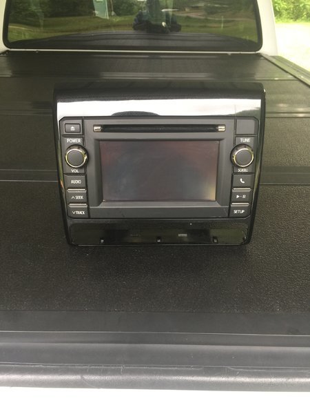

    I have a 13 installed in my 12. I dont have use of my bluetooth and my steering wheels controls. To get these to work you need to build a harness and cut your original wiring. This is something I am not going to do so I am using it as is!

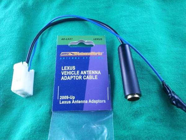

    just go to any stereo install store and buy the antenna adapter, I just picked one up for 15 bucks and you have to wire a lil blue wire to power, as for the antenna I mean,,, the usb and steering controls are still no go as of yet,,, btw im doing the exact same mod on my 2012,, bull shit Toyota dropped the ball on changing stupid conectors for the same exact functions

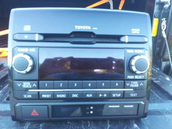

    Okay, I just did this change on my 2012 truck. I only needed two wiring harnesses for the install the PT546-00120CH (28 pin to 20) and the antenna adaptor that i got from Best Buy for 12 dollars. Everything is Plug and play. My truck came stock with the phone mic already installed. I will get back in a few days to update everyone.
    Got to see if I can get the Sirius to work I don't think the 13 came with.
    Also I'm not sure if the steering wheel phone prompt works on the 13.
    PT546-00120-CH
    antenna adaptor
    2012 stock radio with sirius radio and hands free phone
    2013 touch screen

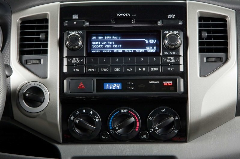

    2014-toyota-tacoma-radio.jpg Ok wow I'm ordering a 13 touch screen non JBL just regular touch screen right now I have a 12 just regular it does have sat radio built into it. The one below is the one I have and I'm ordering the one below it. What do I need to do? Help please before I order.
