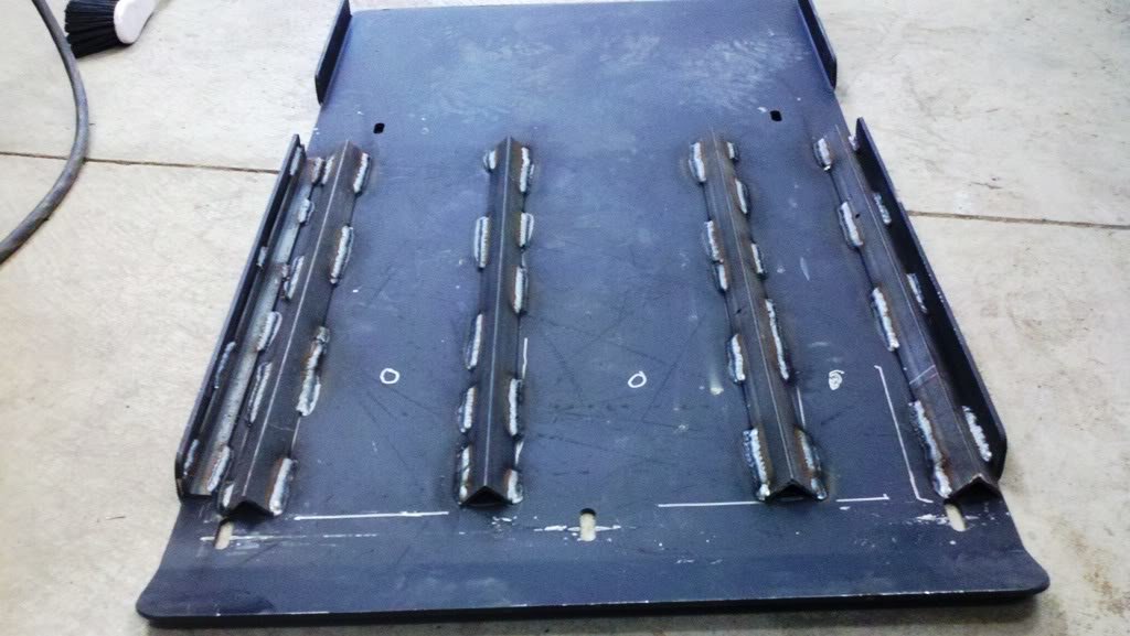

    I believe it does. But not going to keep it from bending. Ill try and find a pic of what im taling about. You weld the angle onto the skid in the cent so it forms a triangle.

    I know what you're talking about and yes, that does increase the rigidity of the skid. I'm just saying that the bend on the edge does help keep the skid from bending. (emphasis on help)
    If the bend weren't there, the skid would bend and deform with even less force than it already takes.

    this is a sweet design with reinforcements
    so this doesn't happen :laugh:
