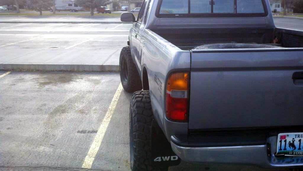

    ok well heres some addition to the mix... the 285s are on(no dot ur not getting my new tars:cool:). they do rub the frame slightly. but its enough to worry me. They do clear the gussets remarkably. I have about 1/2 inch on both sides. im thinkin i will be ok... im thinkin aired down, the buldge is on the bottom... top shouldnt buldge too much more... i plan to air down sat and flex it and see how the tires react.
    as for the frame rubbing. if i run spacers, it wears on the bearings and causes me to beat the fenders in more, alot more....
    or i lengthen my steering stops like silas did and sacrifice my steering radius....
    discuss:D
