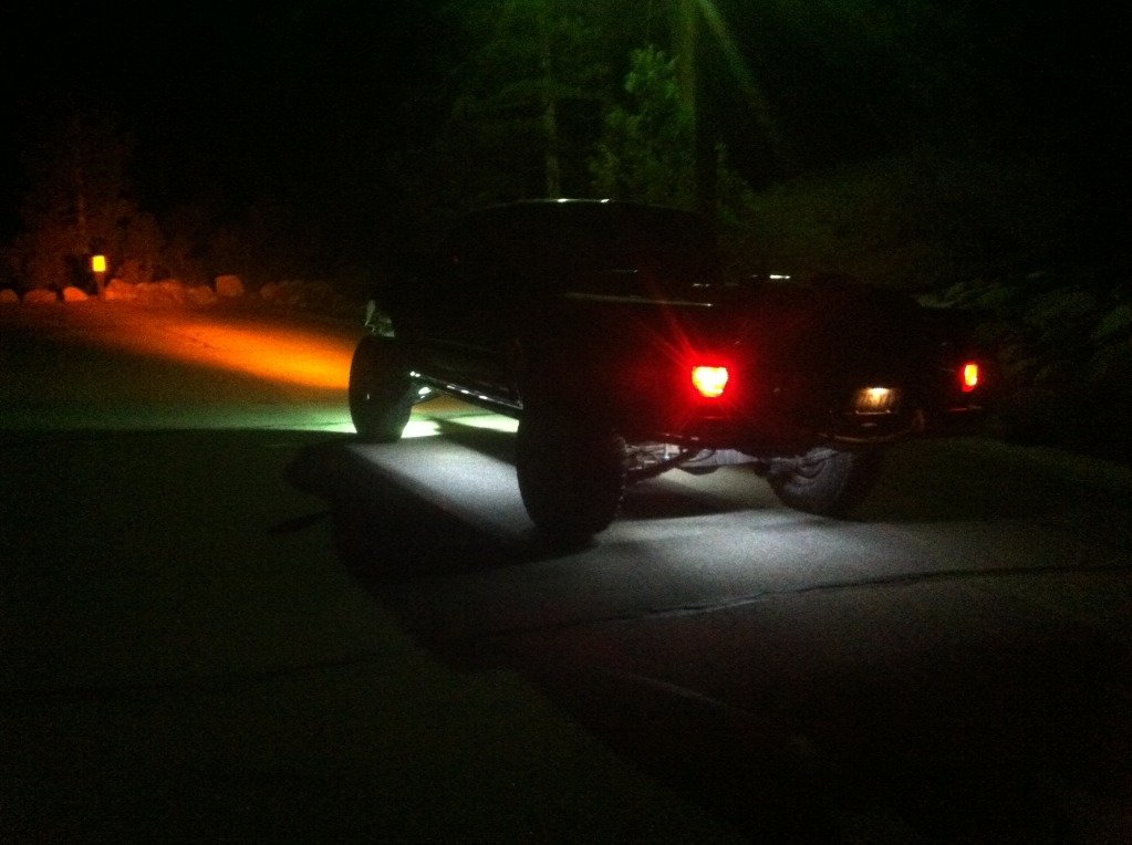

  16. May 9, 2013 at 9:09 PM
    #4236
    jberry813
    Jan 21, 2011
    #49636
    28,478
    Jason
    Lake Tahoe
    2012 DCSB Sport
    ...too much shit to list.
    Ready for night wheeling... :D

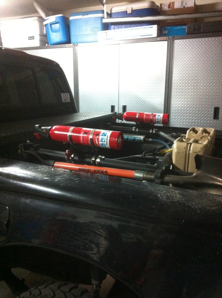

  17. May 9, 2013 at 9:14 PM
    #4237
    NativeTaco
    NativeTaco Mountain Man
    May 29, 2012
    #79689
    4,967
    Travis
    Fort Collins, CO
    '08 DCLB
    ARB, OME, BAMF, ATO, Rigid, more... Mountain Man Limousine
    That is one of the last few things I need to do. And get a fire extinguisher and a few other safety things lined up, buy and replace fluids and figure out how I will be packing things.
    Might have to replace brake pads and shoes :(
  18. May 9, 2013 at 9:18 PM

    Hey what floods are you using for rock lights?
  20. May 9, 2013 at 9:23 PM
    #4240
    jberry813
    Jan 21, 2011
    #49636
    28,478
    Jason
    Lake Tahoe
    2012 DCSB Sport
    That's top secret. :spy:
