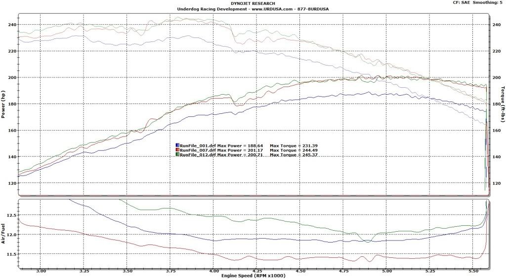

    Was just reading through the thread and saw this chart...
    Originally Posted by XrunnIT [​IMG]
    Here is a dyno done by a 3rd Party(URD), comparing two aftermarket intakes (TRD, and the aFe Si Stage 2) to the stock intake.
    +12rwhp/+14ft-lbs, which is real close to what is advertised considering ambient conditions and elevations vary
    Click for full-size image (1024 x 568)
    Too bad the chart was cropped to delete the data below 2,900 rpm. Even where it starts, they're all pretty close. I'd be really curious as to whether the stock intake equals or might even outperform the aftermarkets under normal driving conditions of off idle to 2,500 rpms, and suspect that Toyota had designed theirs to work best at low rpms.

    That isn't cropped. That is where it starts.

    Ok, Tor. :)
    At 2,900 rpm, the chart seemed to start kind of high, so I just figured that since it was primarily focused on high end performance, the bottom was cut off. I was only interested in low end performance in the normal driving range and started mine from 1,300 rpm.
