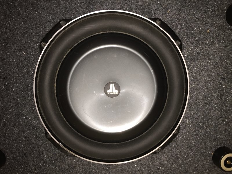

    Hi guys.
    So my subwoofer came today. Came in great condition thanks to fellow member @Marine 8541 also I will be in the process of getting my enclosure built by @Mr Marv image.jpgimage.jpg

    Awesome boxes. Love the feet that provide a little cushion between the box and the seats. Wish my box had that.
