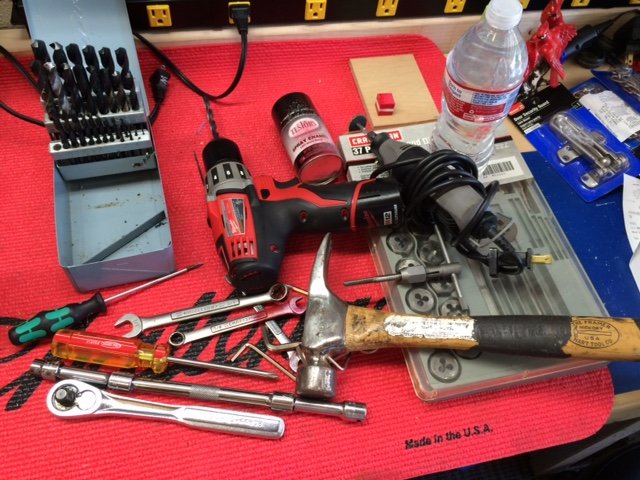

    You will need:
    Actually, just park your truck as close to the garage as you can. You'll be going back and fourth a lot.

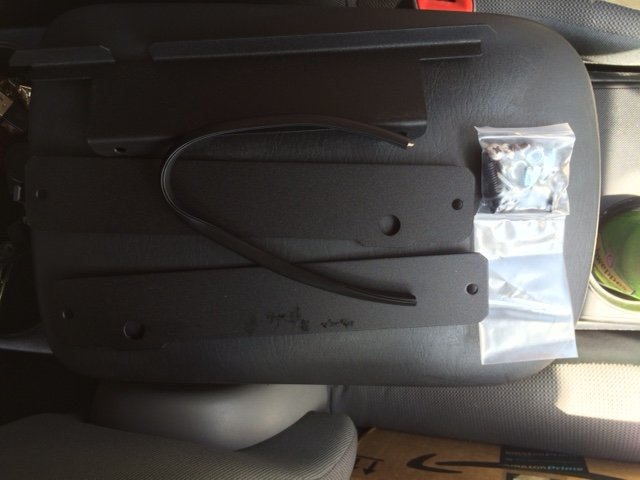

    Step one: Take inventory. You'll have the insert part, two brackets that kind of make sense (they span the bottom of the console and have a hole for the original mounting bolts), one that makes no sense and is awkwardly oversized, a rubber strip to go on the metal edges and a bag of hardware.

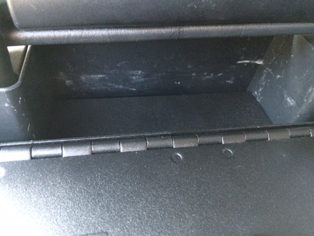

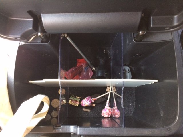

    Step two: Remove the trash & the little piece of carpet from the console. then insert the insert. I REALLY wish I had masking-taped off the inside of the console, so try that and avoid this:

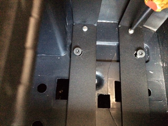

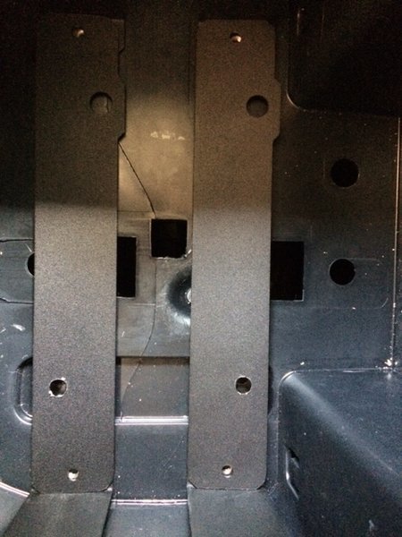

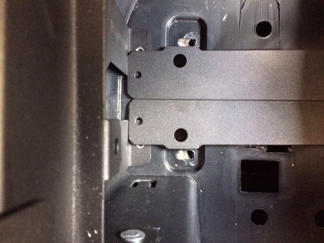

    Step 3: Realize the two brackets that span the bottom of the console to mount the insert (using the original mounting holes) have the holes drill about 1/2" too far to the rear. Take a second an study it, then move on to step 4.
    Step 4: Turn the brackets around then mark where you will drill your new holes. In the steel. Yes really. I marked mine with a scratch awl and had to make a few trips back and fourth to the garage to elongate the holes to get everything to line up. I started with a 9/32 holes but would recommend using a bigger bit to save time. Just don't go so big that the mounting screws Tuffy included will slip through. Oh and since my holes were off, the bolt started funny and damaged the threads in the mounting holes under the console, which I had to clean up with a 6x1.00M tap.

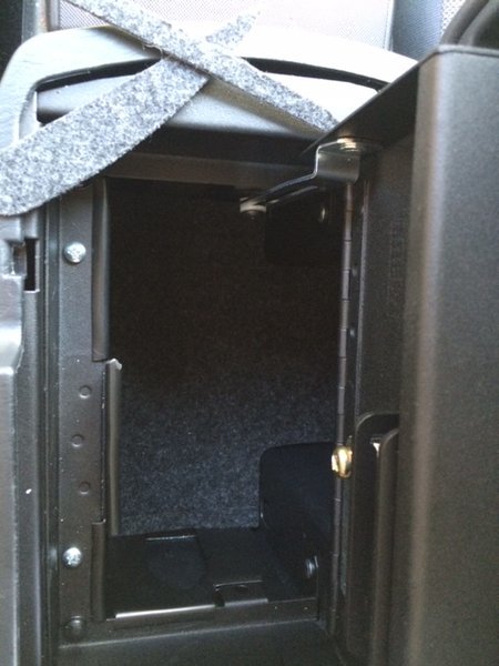

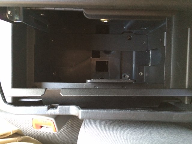

    Step 5: Remember the awkwardly oversized other bracket? Before you bolt everything together, you need to sneak it into the driver side of the console between the insert and the wall of the console. Then it has a couple of screws that hold it in place. This is my least favorite piece of the Tuffy Console Insert setup, it really screws you over later (skip to step 9 and maybe you can save yourself some vacuuming by doing this on your workbench):
    Step 6: Tighten everything up. Good luck with those little screws on the outside of the main brackets, Tuffy left you precisely ONE thread revolution to screw them into. I had to bore out the main mounting bolt holes to get these to line up right.

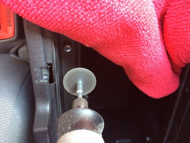

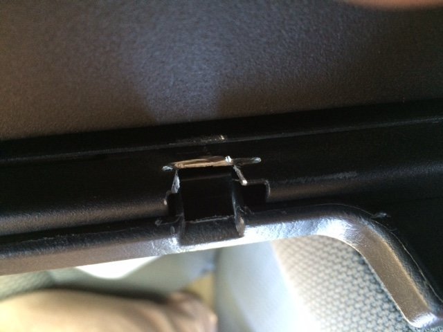

    Step 9: Close the original console lid over the installed Tuffy "safe" - It was a lot of work but at least that project's done. Now to just open that lid back up again... HA! FOOLED YOU! Get your Dremel out, Brougham. Useless awkward bracket is back. It's now blocking the inside of the release lever of the console lid. Smack the lid open but try not to destroy the latch. Here's what you cut out to make it open normally again:2.jpg
    You should end up with a notch like this one, that mirrors the original latch surface:

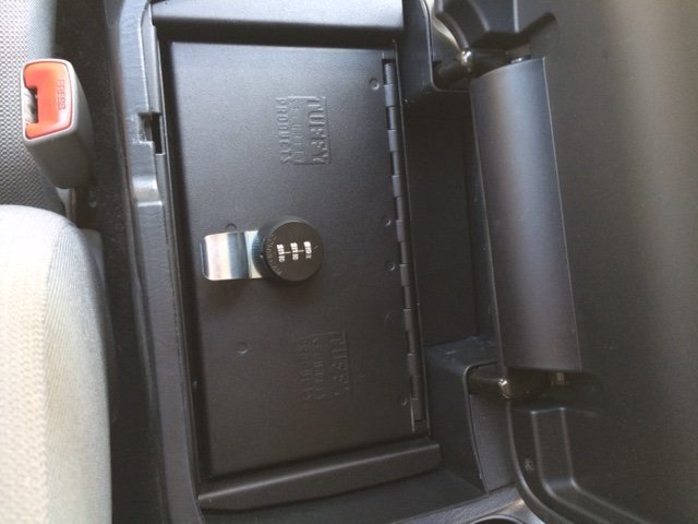

    And that's all there is to it. It actually feels pretty secure once it's mounted. I can yank on the housing and it shakes the truck, which is my usual test for is cargo strapped down securely enough. I don't know if you could pry it open, but I'm going to guess it would at least slow down someone who was breaking into it. Hopefully long enough that they decide they don't want to linger, make noise and draw attention to themselves trying to smash their way in.
