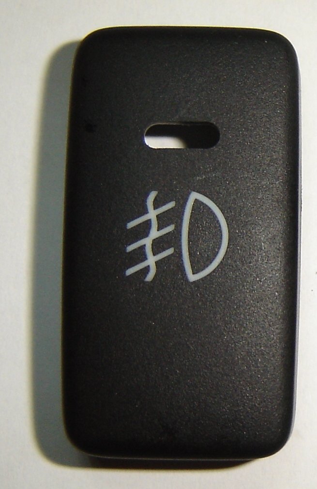

    Mine came pre-wired...I just added the lamps, a relay, 15 amp fuse & OEM switch...

    I only mod'd the OEM switch to illuminate with the dash.
