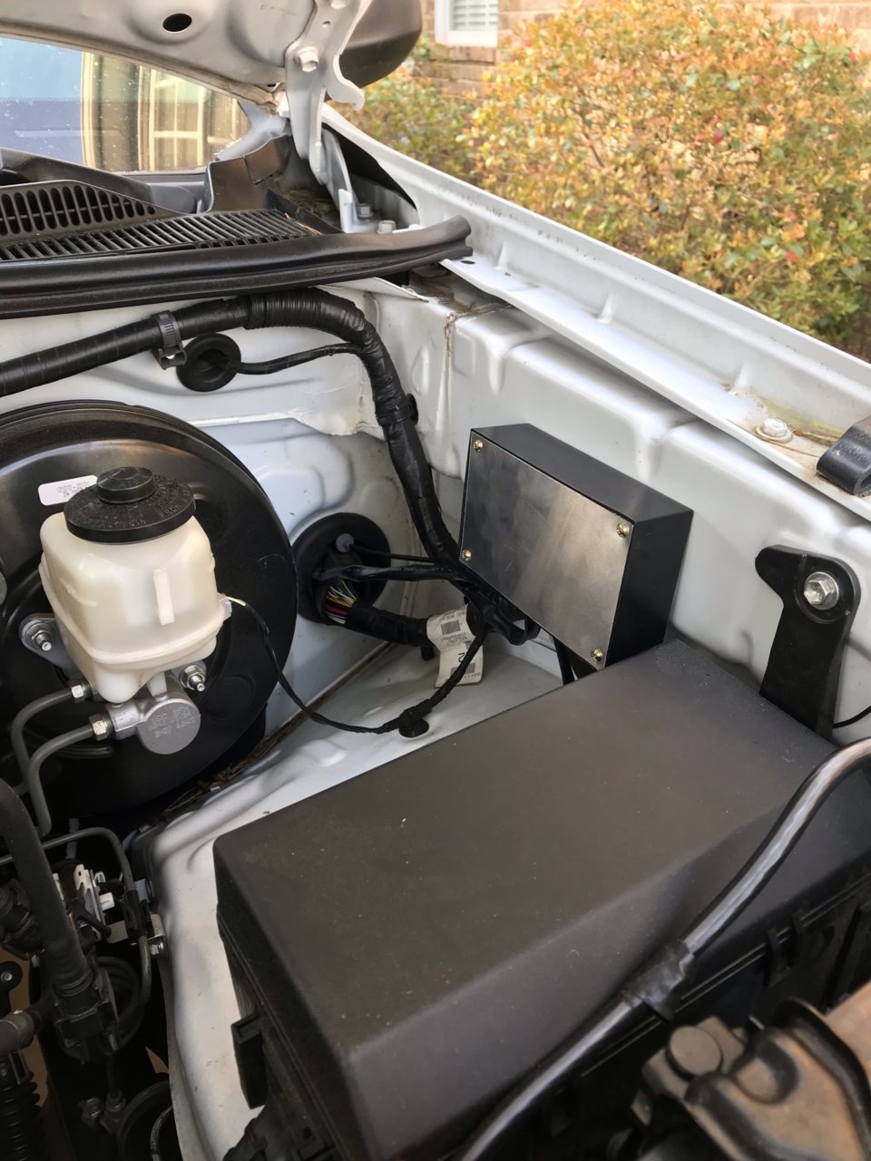

    I guess they come wired differently per the brand. I had to run the end of the harness through the firewall. It plugged into the dash switch and gets power from a tapped fuse. The red wire with an online fuse I connected to battery, and ground wire to the frame. The rest of wiring I put into a small box I bought online and mounted to the upper area near the master cylinder.

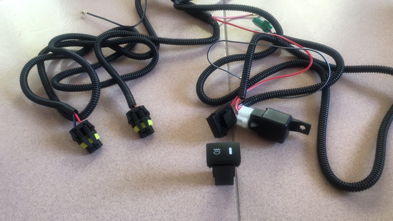

    mmexport1573343096676.jpg Can I strip the red wire and slide it into a a existing fuse or can I tap it with a Quick Splice? Because I don't have a Add-a-fuse..

    Does the green plug have a wire coming out of it that separate?

    Nope
