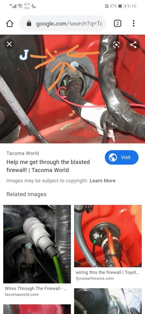

    And I didn't know how to make a hole in the firewall, so I just use a screwdriver and open the boot to feed the wire in

    7,489
    NOOOOOOOOOOOO!!!!!!!!!!!!
