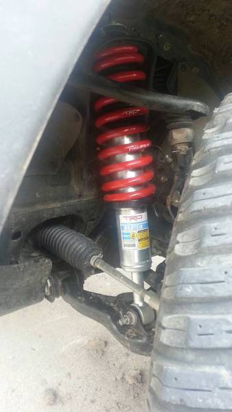

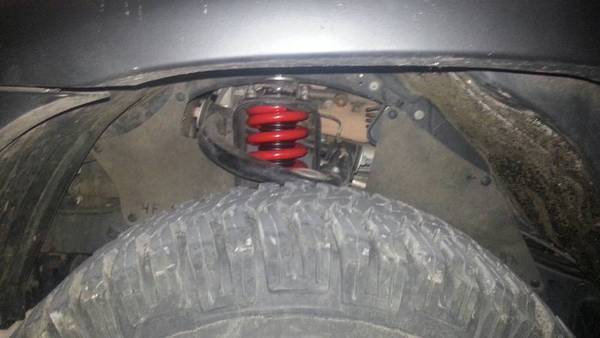

    Traded the 2015 TRD Pro 6spd Supercharged on a PowerWagon and could not be happier. My 2011 Tacoma with the TX Baja package (Added by me) is still treating me great. My 1985 Toyota never skips a beat.
    OR you can buy whatever tacoma you want and put the Baja suspension on it for $1550.

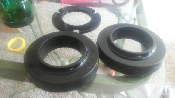

    It is more like 1.75-2 inches higher in the front, i preloaded my springs with the daystar(i think) 3/4 poly isolators that wheelers sells. And i love it. In my opinion it rides way better than the stock offroad suspension did, and i have not had any issues at all with it.
    I also did my Mom's truck (2011 sport) and she loves it as well.
    It rides a little bit stiffer on the highway but it rides much much better offroad dips etc.
    I also removed my sway bar

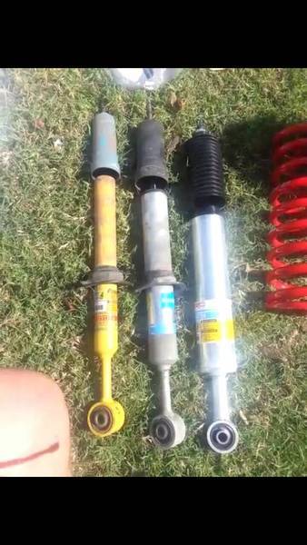

    Im not saying that there are no better etc etc, but i really like it.
    I have 5100's on the 4runner and its quite a bit different.
    i made a ramp to jeep park in my friends back yard, the trash was there and we were bored.
    i never used the 1/4 spacer, i dropped the pass side coil to the 1/4" lower ring instead so i wouldnt have any top spacers
    add-a-leafs untill i buy new springs
    trd, 5100, baja
