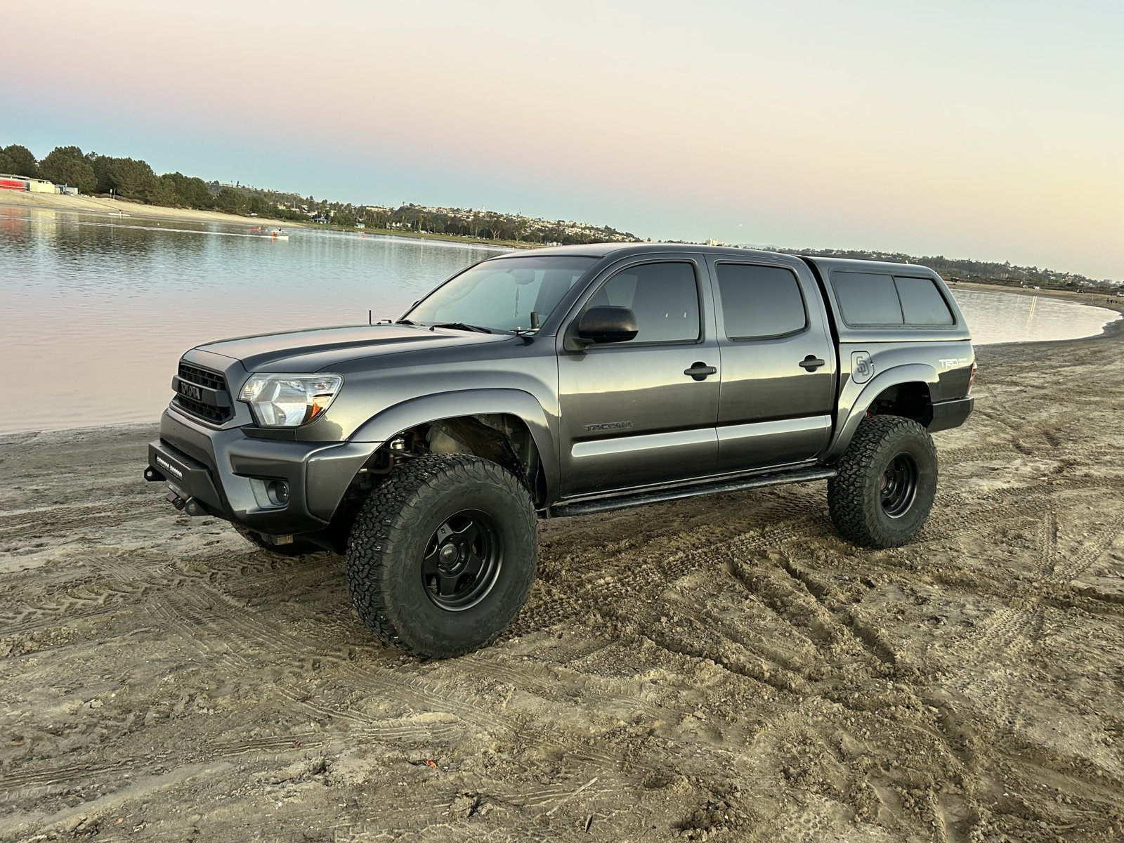

    Ended up selling my practical daily and got a good deal on a fzj80 swapped the wheels and tires from the two so the taco is on 315/75r16 scs f5 16x9 -2547C88D18-8996-4940-8EFC-6AE5B2FC0D71.jpg

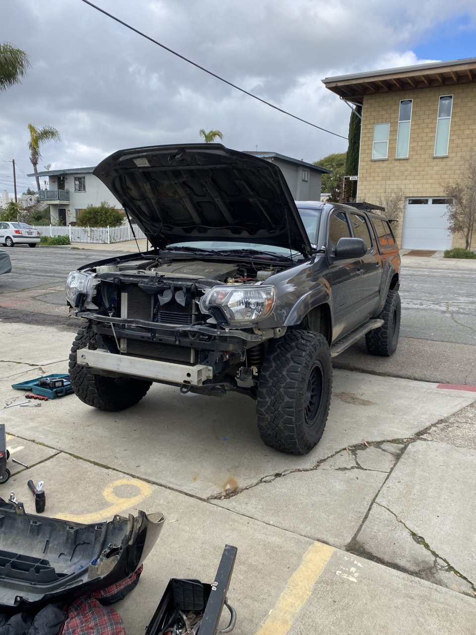

    Did the crossmember cut and put on the c4 rock runner bumper and skid.

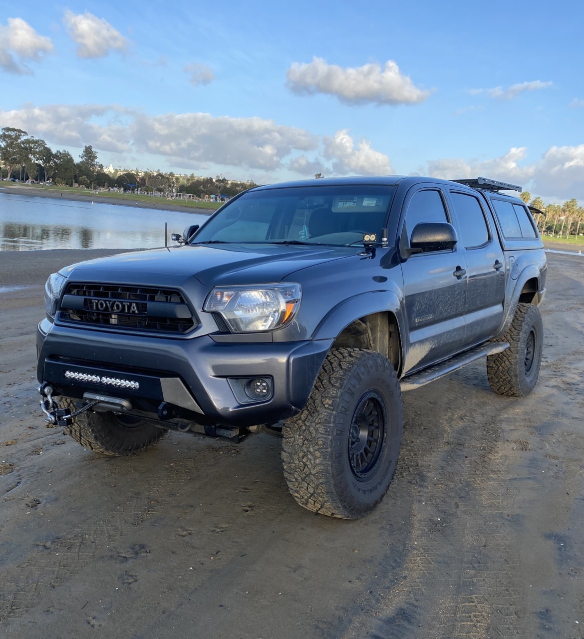

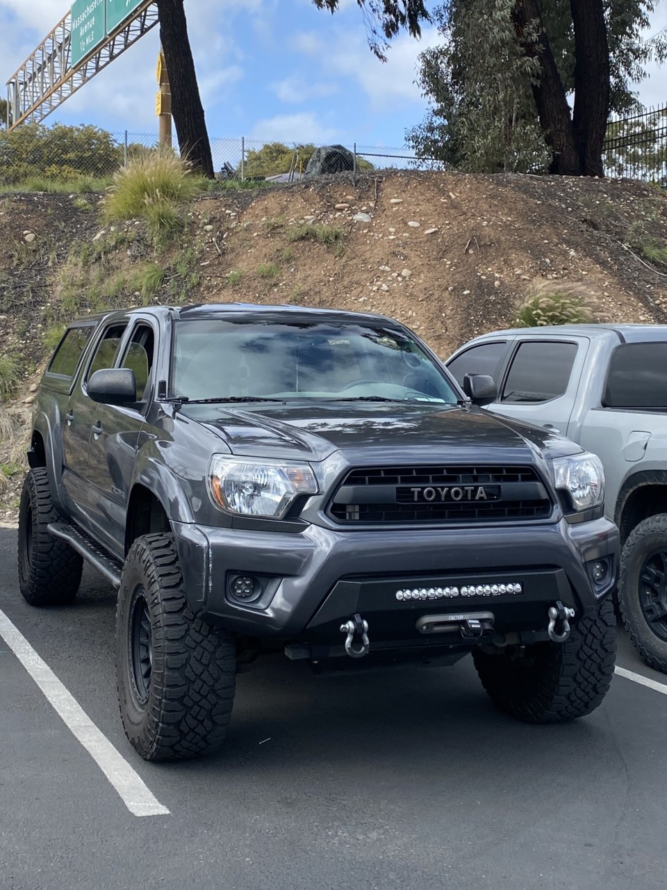

    Mounted some s2 sae for fogs in the bumper wing. Had to get creative to mount them.

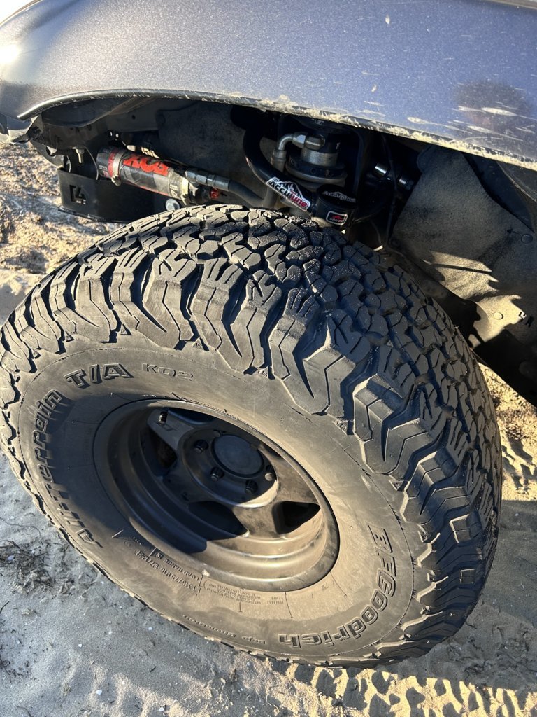

    Coeur d’Alene, Idaho
    Are you running spacers on the rear for the shock relocation?
  10. Feb 19, 2025 at 9:42 PM
    #70
    Beefchief
    Beefchief [OP] Well-Known Member
    Oct 29, 2020
    #345245
    79
    San Diego
    2013 double cab trd off road 4x4
    no! Clears the shock body just barely with the -25 offset. I had -12s before and they rubbed the shock body like crazy
    Oreo Cat[QUOTED] likes this.
  11. Feb 19, 2025 at 10:36 PM
    #71
    Oreo Cat
    Oreo Cat Worst Member
    Sep 19, 2016
    #197755
    5,349
    That’s good to hear I’ve been on the fence about going this route because I don’t want to run spacers but now I might just take the risk
  12. Feb 20, 2025 at 8:21 AM
    #72
    Beefchief
    Oct 29, 2020
    #345245
    79
    San Diego

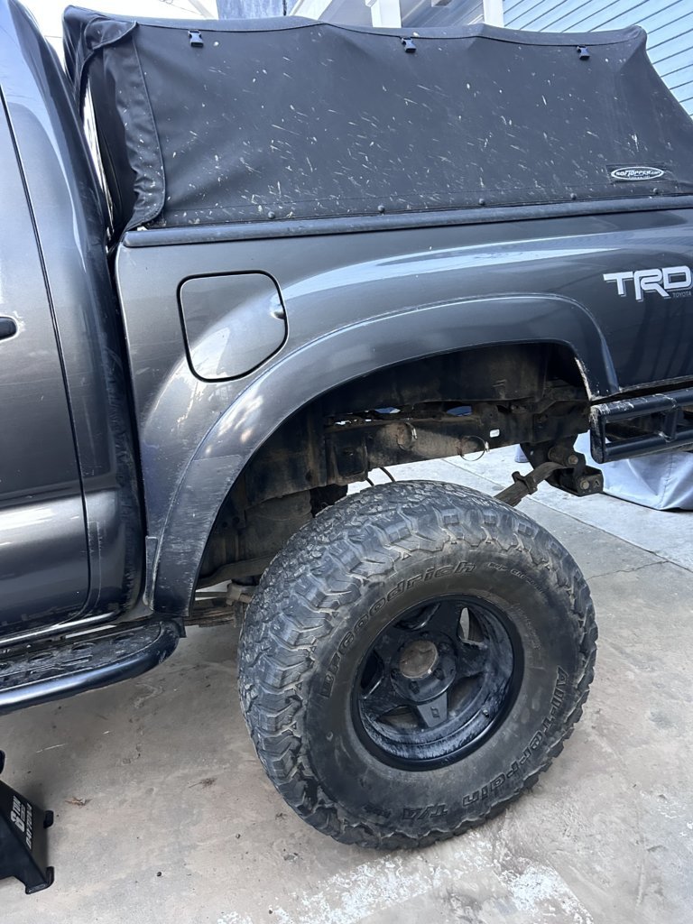

    I feel you. I didn’t wanna run spacers either. So far so good. Might barely kiss it when flexed all the way but other than that no. C21E5A04-459F-4CE5-8F8A-29D1CE6A12E1.jpg

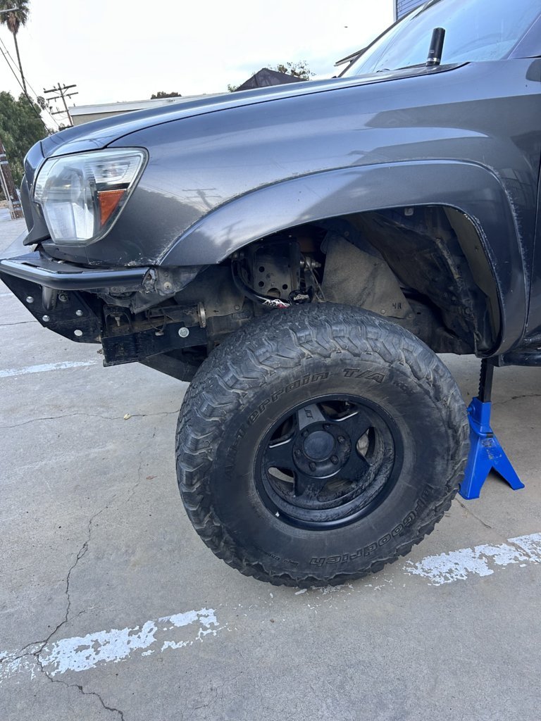

    Had my ball joints on my spc uca’s going bad. Instead of replacing the joints I thought I’d try something different. Went with the accutunes. Slapped them on and maxed out the lca cams to help clear the cab mount a little better. Got them aligned and I have zero rubbing with the fenders cut and a cab mount chop in normal driving. Very impressed. Even reversed full lock. I have yet to wheel with them and I’m sure I’ll rub but it’s so much better.

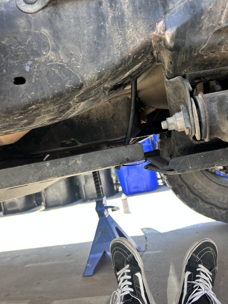

    Had a very a boring week with the truck on jackstands while the shocks got rebuilt by accutune. Knocked out some maintenance and some cheap easy mods i wanted to do but never had the time. Drained only 5 quarts of oil instead of 5.5. Found a small oil leak on the passenger valve cover gasket. Will have to knock that out soon. To be fair the truck has 172k on it now and the only thing that’s failed was my clock spring on my horn, passenger cv axel seal and now a small leak. Not bad.

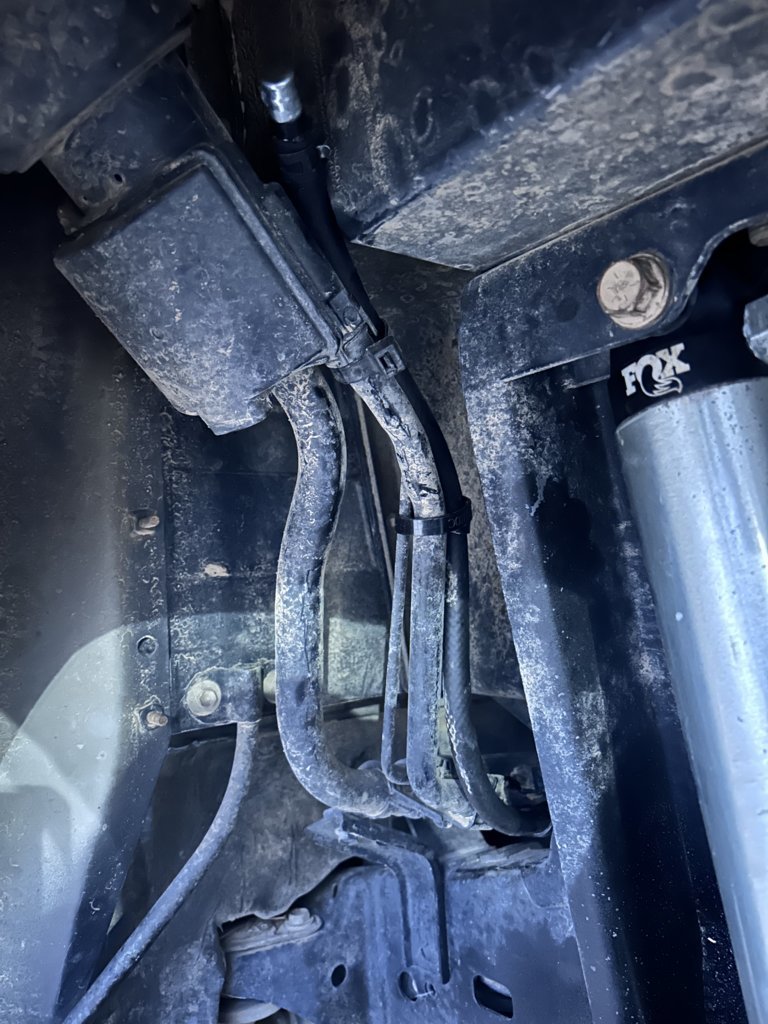

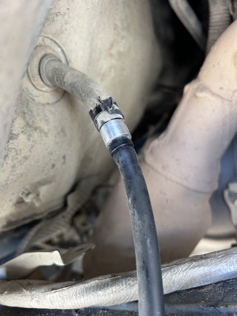

    Super easy but helpful mod to keep your ac drain condensation from dripping all over your frame and skids. Toyotas don’t need any assistance rusting. There are very inexpensive ways to do this but I picked up a kit from vorra65 who machines these little reducer couplers and sends you hose. Kit is made in USA and very clean aesthetically. I had spare Toyota oem hose clamps that I purchased for another project but ended up being too small. Ended up working perfectly to secure the union to the factory condensate drain. Routed the drain just below the skid.

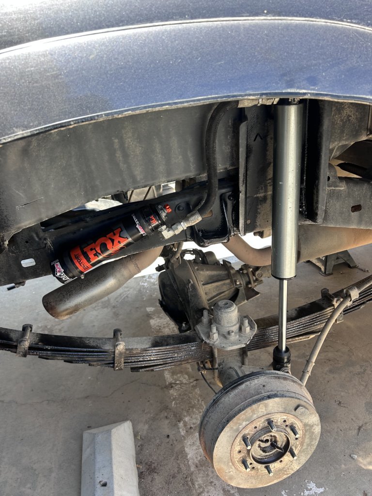

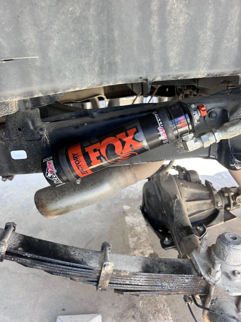

    Got my rear smoothies and coil overs back from accutune and slapped them on. Put heat shrink on the hose clamps that secure the reservoirs for a cleaner look. Feels great to have it back. Truck rides nice and the adjustments with the dsc are great, especially if you’re not running a front sway bar. About 1100 bucks for a rebuild though so hopefully not for another 40 k miles IMG_7409.jpg IMG_7408.jpg

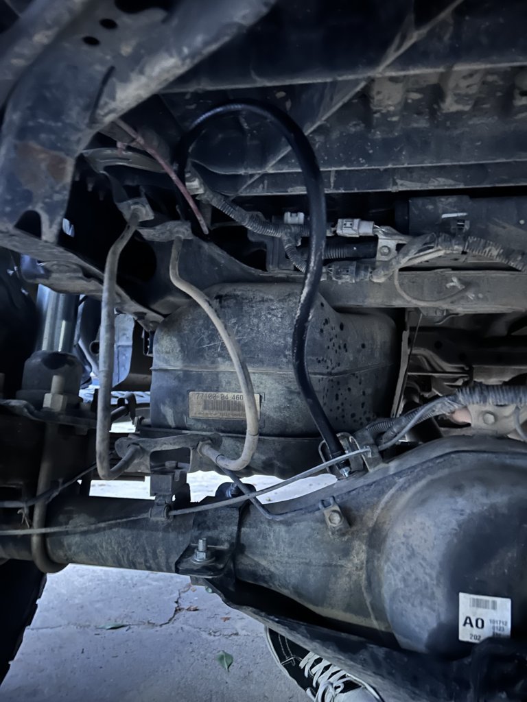

    Last cheap easy mod because im addicted to tinkering now days. Diff breather mod, re routed up towards the filler neck. Again had spare Toyota Oem constant tension clamps that cleaned it up a bit.
