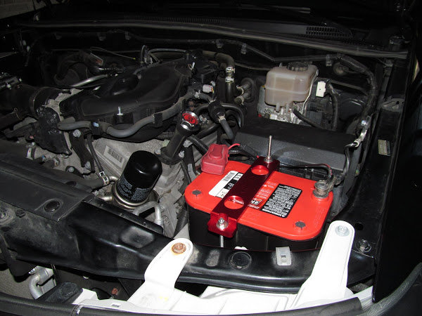

    If you don't run a winch, compressor, or other high-wattage items, an Optima Red Top will let you save about 20 lb over the OEM battery. Best price I found in Canada: http://agmautobattery.ca/product/8020-164-35/
    720 cold cranking amps.
    I have this battery. Also installed a PowerRev Racing aluminum battery hold-down P/N P017 intended for Toyota 86 and a pair of 8" J-bolts from my local auto parts store.

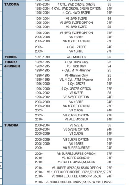

    thanks. had to settle with a 24F. price same for batteries. they tried putting a 27 in and i said i need a 27F. Sam's club now shows 24F as replacement battery.
    No 27F at Costco (in my area).
    _________
    The 24F wouldn't strap down so I went to dealer and picked up a 27F.
    Also contacted Johnson Controls:
    Thank you for contacting JCI Customer Service. Below is a link to the JCI sponsored website where you can search for a fitment. Our website does show that a 27F is required. If you are looking at the Wal-Mart sponsored batteryfinder.com website it is most likely because they do not offer a 27F battery, but that is something that would be addressed with Wal-Mart who operates the website.
    http://www.autobatteries.com/en-us/...=Toyota&model=Tacoma&engine=V6-4.0L&find=find
    Thank you,
    Mary Jo
    JCI Power Solutions Customer Service
