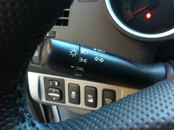

    any follow up on this? I have a 13 headlight switch with the drl off option. I also am doing the 13 steering wheel swap on my 06.

    after chasing and chasing threads i decided to look in the switch itself. found that the 2013 switch has one more wire for the drl on off option. so I got a 2013 plug and removed the white wire and installed it into the factory headlight plug ran a jumper wire to the green/red wire from the drl relay/flasher and wammo factory on/off drl option
