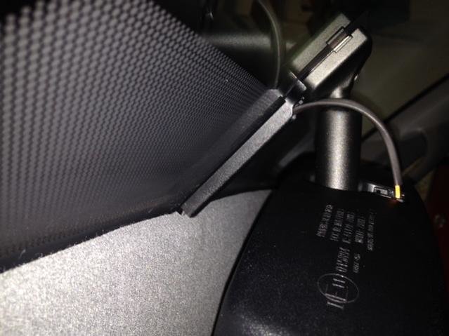

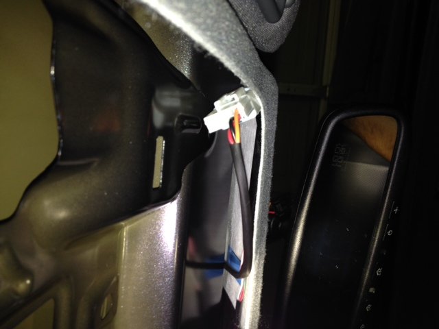

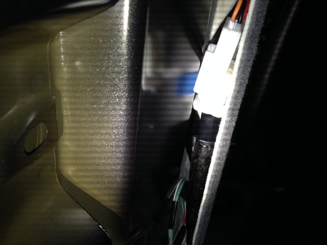

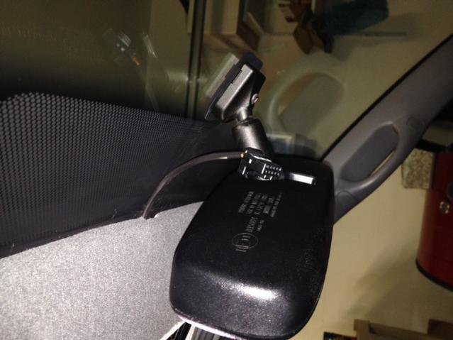

    Hey guys,
    Just got back from vacation today and the mirror i got from Bob was waiting for me on my front doorstep. I literally walked in with my luggage and decided to install the mirror. Took me only 15 minutes to put it in. The only thing i had to adjust was to cut the trim piece a little bit. hope these pics help.
    Came to find out that I had to change the zone on the compass from 8 to 4 since I live in Nor Cal. Also, one thing i didnt' really like is that the homelink buttons work all the time even when the truck is off with no key in the ignition. I was hoping to have it only on when the key was in the ACC mode. But all in all..perfect install and looks OEM
    Thanks BOB!
