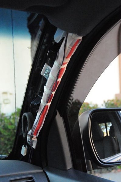

    Just wanted to give a shout out to Bob (RJP869). Ordered one of his autodim/Homelink/compass/temp mirrors. Just as promised, it came with the 14 pin factory connector installed with wires shrink-wrapped and cut to the perfect length. He is a true professional.
    Install was very easy, took about 2 hours to fully install. Mounting and running the temp sensor was very easy and straight forward. I am very particular so I took a little extra time to run the harness along the factory wiring and zip tied it in. You can't even tell it is an aftermarket install.

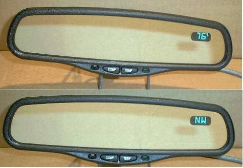

    I've had a few people request this in the past & that little light in my head just didn't turn on at the time, lol!:p Some of you wanted a mirror with just autodim & temperature. While that technically does not exist, I have something that might just do the trick. Now before everyone gets too excited...it's NOT for the Homelink mirrors unfortunately :( ...those are still either compass only or compass/temp, sorry about that.
    But anyhow...Gentex made an autodim compass/temp mirror a few years ago that would display EITHER compass OR temperature individually. If you wanted the compass display, you press the compass button. If you want temperature, press the temperature button. Cool thing about this is that the mirror stays on the setting you last had it on, so if you set it to temperature, it stays there, so the next time you turn the vehicle on, it will still be displaying temperature.
    So...with that said...I am gathering up some nice used ones to keep on hand if anyone would want one instead of the "dual display" compass temp mirrors. They are not available new anymore, so all that I can offer are nice used ones. They will have the regular light blue display, and will still come with the Tacoma wiring, temp sensor & associated wiring & wire cover like all the other mirrors I've been supplying. Kits will cost the same as the other used compass/temp mirror kits, $139 shipped.

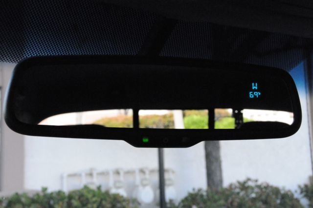

    I just installed my new mirror, went in quick and easy, thanks RJP869! Here are some pics. I also have the mirror bracket from ImMrYo and it fits nicely with the mirror.

    what mirror is this?

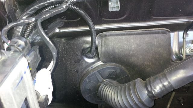

    Installation notes. I made two holes about the wire size in the firewall's grommet with a "revolving leather punch" that I had -- the sensor wires were a bit tough to get passed through the grommet. When passing the wires though firewall, I used a new blade in a small Exacto to make a small "plus sign" cut in the carpet from the engine compartment side of the grommet's 15mm hole (not wanting to go very deep due to vehicle's wiring on the inside); the wires were pushed in from the engine compartment followed by fishing them out from behind the vehicles wiring (hidden above passengers feet and in front of the glove box which has to be removed). That is where the purple wires running from the new mirror's connector (along the headliner to the right, then down the right hand pillar) and the wires coming from the sensor were joined within the cab using the crimp-type butt connectors (there is no polarity....purple wire from sensor to purple wire from mirror connector, and repeat). The wires were coiled-up and lightly tie-wrapped to the vehicle's wiring harness. The pillar cover comes off by taking out the handle's two 10mm bolts with a 10mm socket...you'll "booger up" the Phillips head if trying to use a screwdriver since they are torqued-down pretty good...I know by trying on the first one. The overhead console comes off by removing the Phillips head screw in the middle of the rear compartment, then pulling down on the front of the console with a bit of force, it will "pop out" from the two spring clips.....don't pull down too far as there are two connectors that need to be removed from the console (for the microphone and the overhead lights' power). I found the white connector taped-down (and taped-down pretty good too) within the headliner between the removed overhead console and windshield. The new mirror's "wire cover", the sliding plastic piece that covers-up the wires from the headliner to the mirror's mount, was found to be too long too -- I had to cut-off about 0.75" from both pieces for it to install properly (I used some flush-cutting diagonal cutters to make a clean cuts in the hard plastic since worried about cutting my finger if using an knife or something else).
