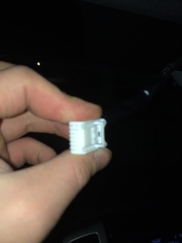

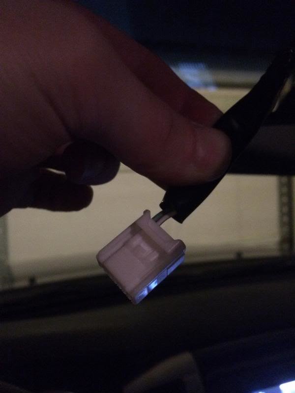

    So here are some pictures of the wiring that is in the 2014. Can anyone tell me if that is a similar harness to that in the 2013?

    That's the plug for the rear view mirror but there's some wires missin for the camera ifim not mistaken

    That only looks to have power and ground. If you have a tester, see if provides power when the ignition is in acc mode.

    So I just tested the power on the harness up in the headliner and it is ground and 12v accessory.

    If would have to be custom if all the 14's have only the 2 wires in the plug like Domreis posted above.
