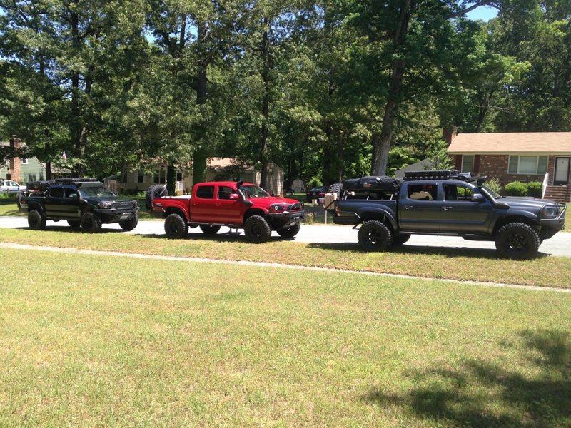

    6800# on the scales... (Last truck in line) Think payload capacity with that set-up is more than enough.

    That was a full load of fuel, 2 people, and gear for 11 days on the road.
