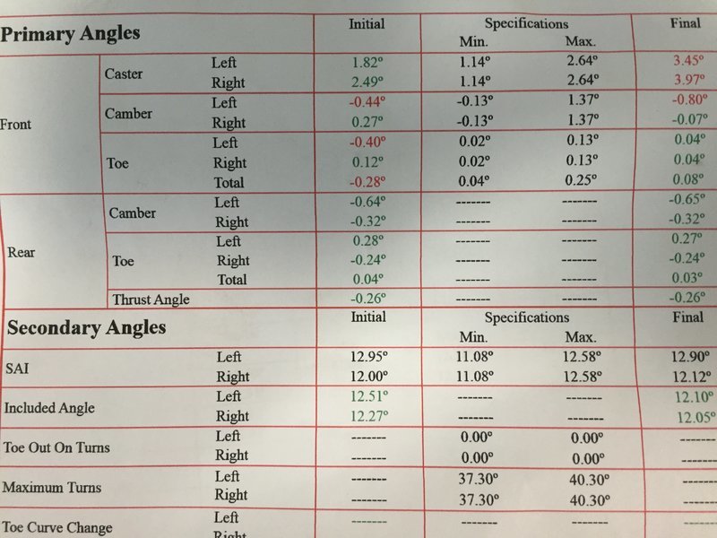

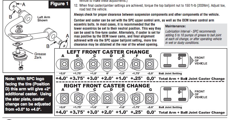

    Putting this here for later:
    And from bjmoose:
    * If you increase caster AT THE TOP of the spindle, you decrease clearance, because that moves the spindle hub back.
    * If you increase caster AT THE BOTTOM of the spindle, you increase clearance, because that moves the spindle hub forward.
    * On the stock truck, caster and camber must be played off against each other, because the combination of eccentric cams on the lower-control-arm affects both caster and camber.
    * But the adjustability on the Light-Racings means you can set Camber at the top of the spindle, in addition to setting caster there.
    * Toe is adjusted by the tie-rod ends, and is a completely separate adjustment.
    So, to maximize clearance:
    1. First, Maximize caster using the eccentrics on the lower control arm. Do not worry about camber at this time.
    2. Reset the caster cams on the UCAs to the minimum value to bring Caster to an acceptable value. I decided to trade off a little less caster for a little more clearance here, and moved the UCA cams to the "+1" position (One degree LESS than neutral, and two degrees less than I started)
    3. Set the camber using the UCA adjustment slide.
    4. Finish off toe normally.

    Just got it back from alignment shop. No more rubbing on pavement without CMC. Looks like I have a ton of room in there now compared to what I had before.

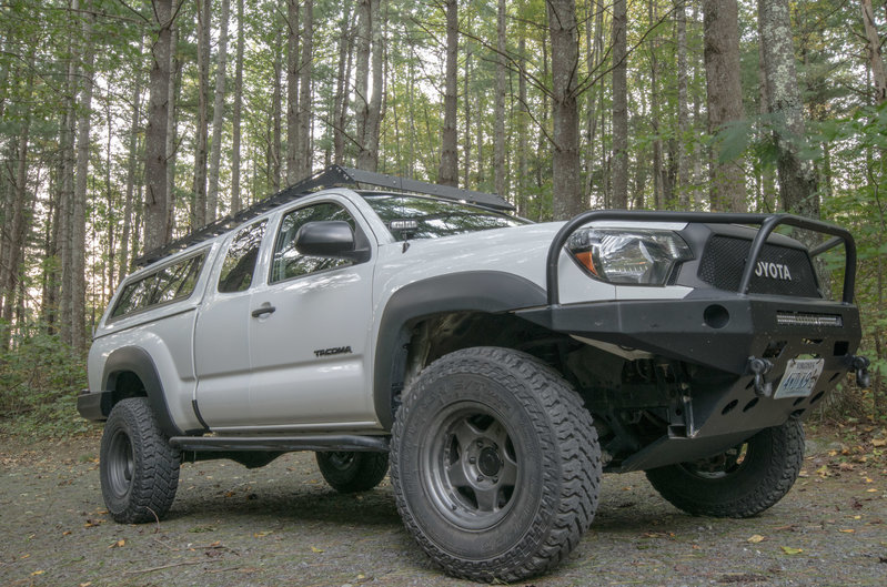

    Took the ol' girl to the mall to test out the new shackles. Still had a little bit left in her but i'm happy with it for what ill be doing.

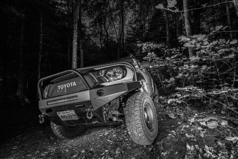

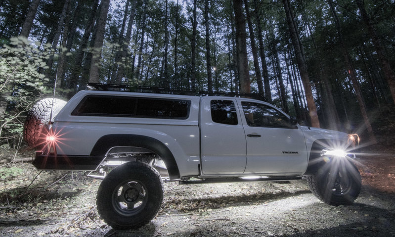

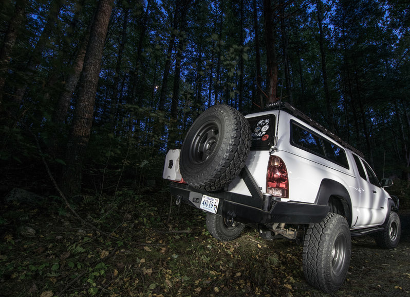

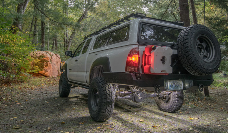

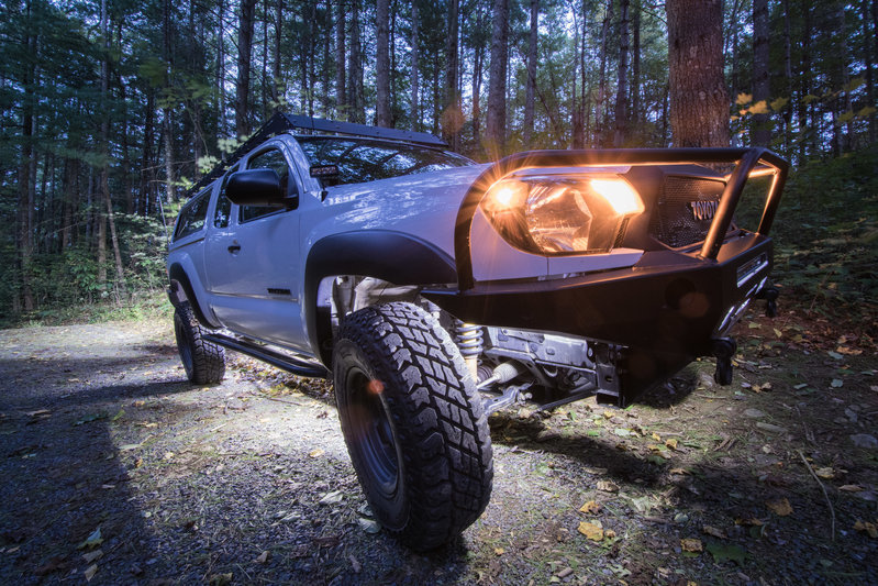

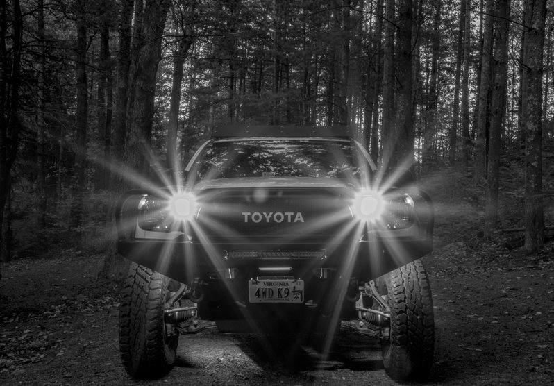

    And well, tbh since I didnt fill the freezer this weekend, I was desperate to shoot something. The truck will have to do for now.
