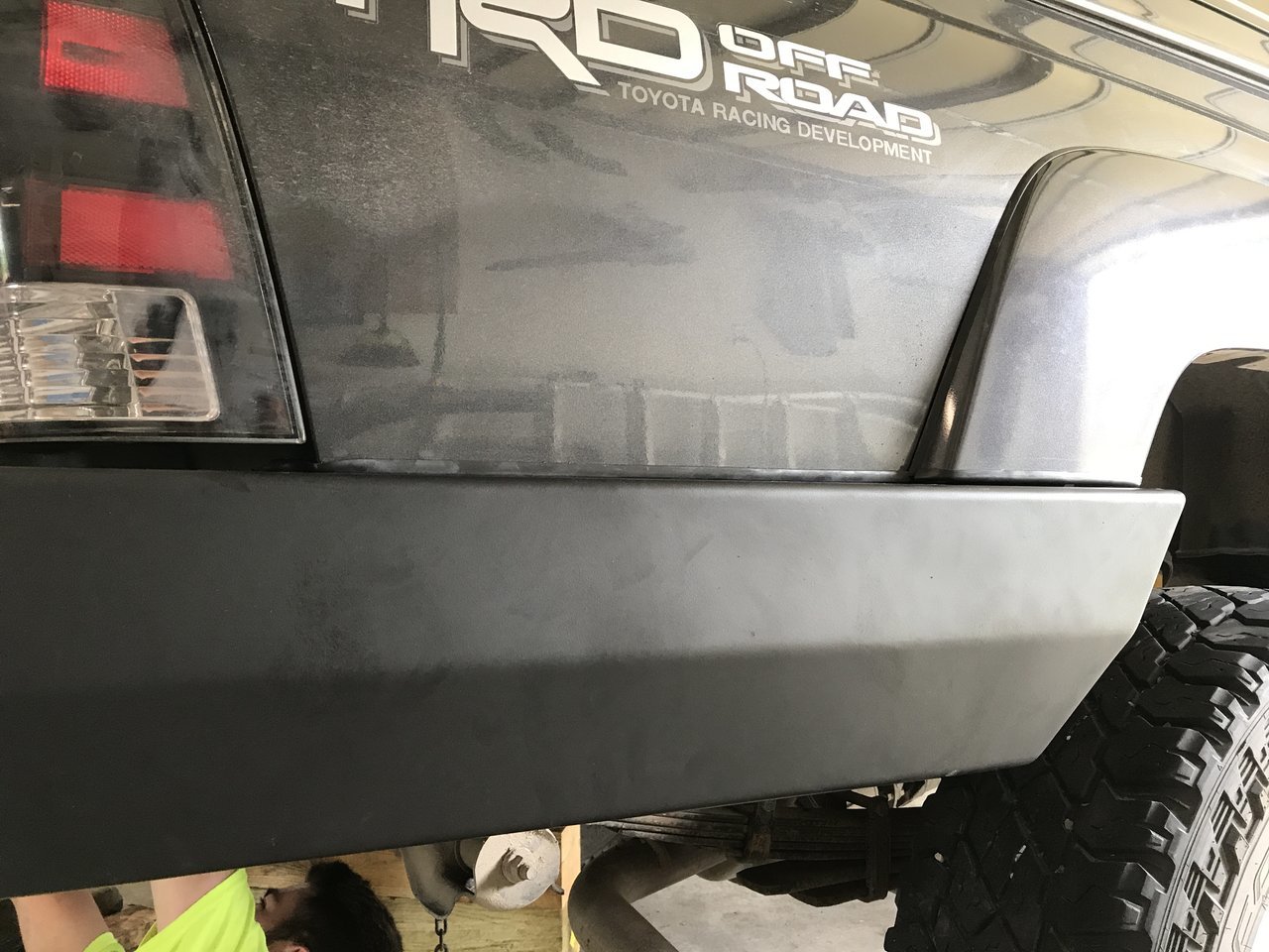

    Don't have any good shots yet, but the install went seamless. Had two dudes help who are SUPER detail oriented, and I gotta say it turned out great. There is virtually no gap across the bed sides and fenders on both sides.
    The only issue was the handle latch, we had to grind down the pin a bit to make it properly pop in. It still has to be whacked to open and close, but I'm sure that'll improve with time.

    Install looks great! Are you gonna clearance more on those rear fenders so you don't crinkle them when your chassis flex during off-road situations? 1/4 to an 1/2 in should be fine :thumbsup:

    That thought did cross my mind.. do you think along the whole cut or just the fender flares themselves?

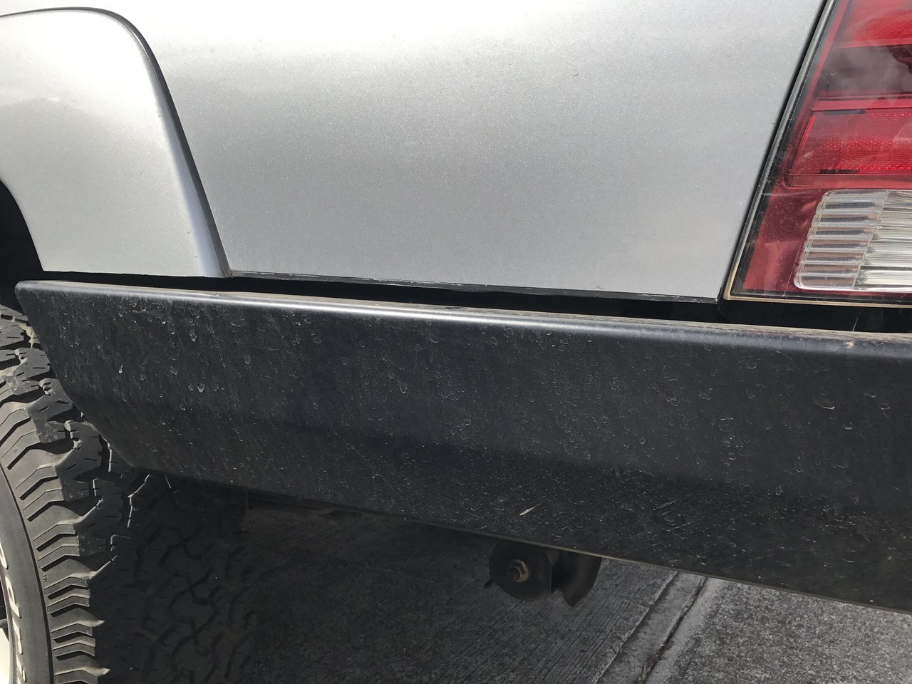

    Whole thing to be safe. I went just shy of 1/2in.IMG_0817.jpg
