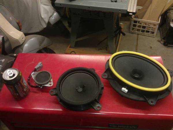

    So, I knew these speakers were bad but holy crap, I couldn't believe how cheap they are. Molded plastic basket and mounting bracket all in one. The magnets don't have enough power to even pick up a nail.

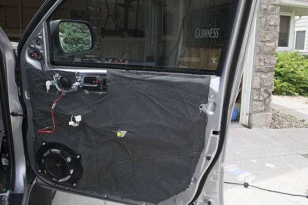

    Here's the front door. I did all of them similarly, Raamat with Ensolite over the top.

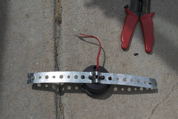

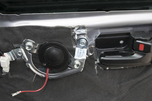

    I was stumped on mounting the tweeters until I figured this out. I used duct strap, attached to the back of the tweeters, then bolted right into the original tweeter bracket.
    I got all the door speakers installed, doors sound deadened, and all the wiring run. I still need to install the LOC and MiniDSP, and hook everything up. I'm beat after today. My hands are shredded- that Raamat is wicked sharp!
