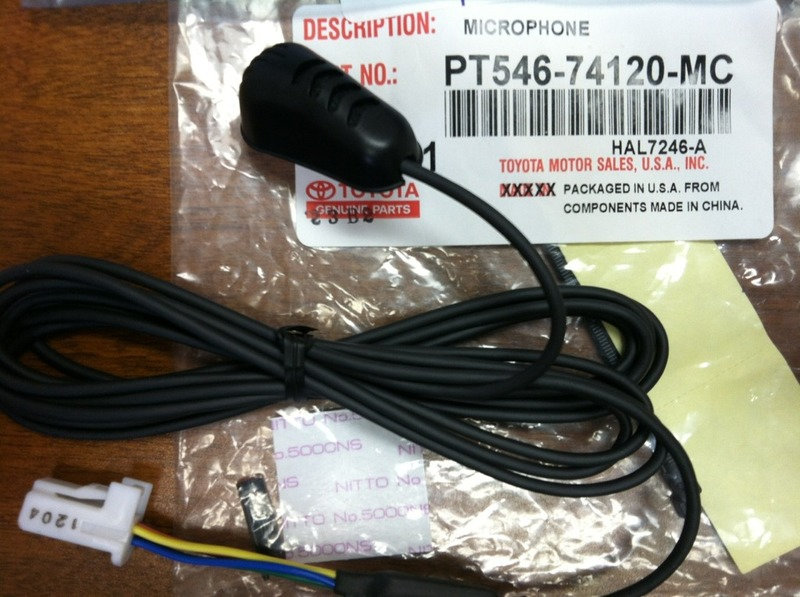

    Haven't had a chance yet to route it to have that factory clean look, but it is installed and stowed in the glove box. I'm still thinking where the best spot to mount it. But I'm limited to where I could put it because of the length of wiring.
    This is the mic I'm talking about. I think the mic that you're talking about that's integrated into the rear view mirror is most likely for the higher end JBL trim.

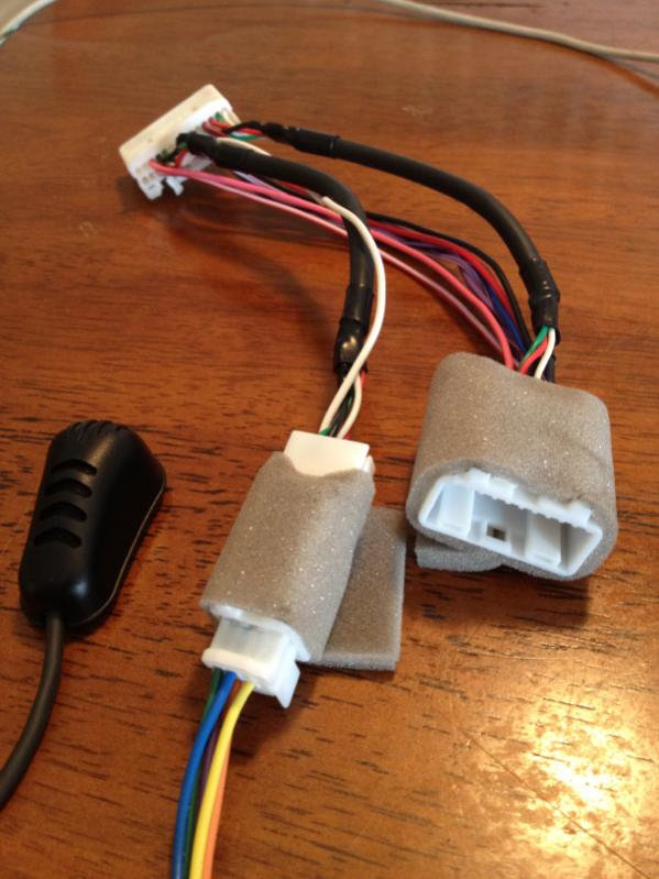

    2015 INFERNO TRD PRO
    Plugs into the 28-pin conversion harness, conversion harness plugs into the headunit.
    Steering wheel audio control plugs into that open plug.
