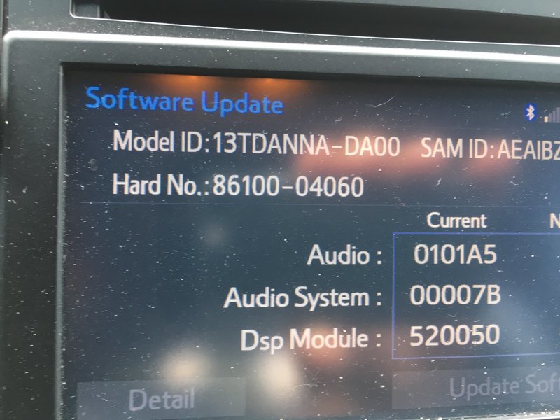

    Hello all... I like many other people on here am having trouble with the entune + NAV system in my 2014 Tacoma. It will freeze up at random times... sometimes it would do it 3 times in 1 hour... then sometimes it won't do it for 4 days... Its 100% random... I contacted the dealer about it and they told me that it most likely needs a firmware update. To bring it in and they will update the firmware for it. I explained that I have 48000 miles on it and am out of warranty... they then told me that it would cost between $65-$120. I can't afford to dump cash to have a "mechanic" place a usb stick in the truck and hit go. Especially not having a guarantee that it will fix the problem. Does anyone on here have the firmware that they would be willing to share? I really appreciate your help...

    what version do you have now?

    This is the only thing I can find...

    My 2015 Nav Entune has
    Audio: 0101D1 5/7/16
    Audio System: 000084
    DSP Module: 820010
    It was updated before I bought it, and has been working flawlessly.

    I tried calling Entune... They said that they don't do that anymore.. They referred me to Toyota....
    App is up to date... that updates the software.. I believe its the firmware that is the problem... Hard to tell what firmware I am on and what is the current firmware.
    This appears to be for previous versions of the stereo... I have formatted the usb stick named it 14A as others have suggested..put this on it and inserted in the stereo... Nothing... as if no usb stick was inserted... maybe I did something wrong... frustrating!!!

    No luck... I insert the usb stick into the port as directed.. and nothing... no prompt... Stick is properly formatted because I can see it listed under devices... but cannot seem to access the files on it... I go to software update screen and I only get the pic I posted previously.. I was hoping that there was a mechanic on here that had the update they can fwd.... frustrating to have to pay another $60-120 for a "firmware" issue..

    My 2014 Entune was running version 0101A5 same as yours and was having similar issues so I took it to the dealer back in May. They upgraded it to version 0101D1 and all issues are gone. My truck is still under warranty so they didn't even mention trying to charge me but my understand is that all firmware upgrades are free regardless of warranty-The map upgrade on the other had they charge for.
