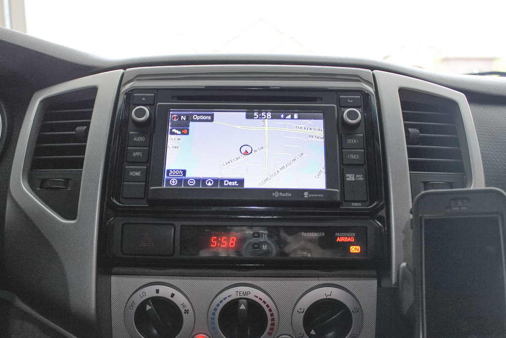

    Okay, so just about a week. I will remain patient... lol
