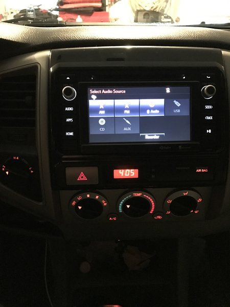

    Just installed 2015 entune into my 2010.
    flawless with no install problems
