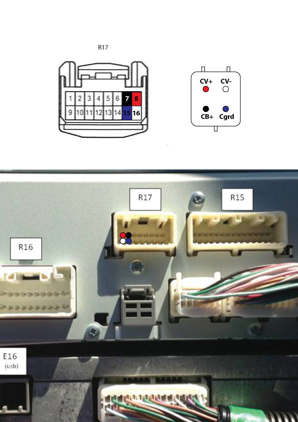

    that was my impression of it too. do any research on getting the rear view camera on the screen? I bought the camera source thing for it, but its for 2013 year. not 2015 which is the year my headunit came from. the plugs dont match up. do you have a wiring diagram for the 2014-2015 unit? I haven't even begun to look into this yet. I'm sure I could find diagrams if I tried

    any chance you have a wiring diagram of the 2014/2015 unit? did they put the backup camera on the screen or in the rear view mirror? I just need to find the wire to tap... the rest will be easy with the camera source harness. i'll end up cutting the head unit side of the plug off the harness
  18. Jul 22, 2017 at 3:22 PM
    #398
    Redmann
    Redmann DILLIGAF
    Dec 30, 2016
    #206119
    6,994
    Reds
    Not Philly
    2009 AC TRDOR
    this looks promising.
