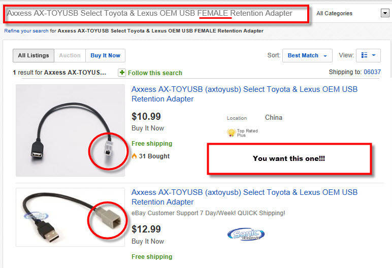

    The only male one I can find ships from China, is there any other place to get it. They take anywhere from 2-4 weeks

    Do you have the mic installed?
    Not sure what's out there for ebay right now
