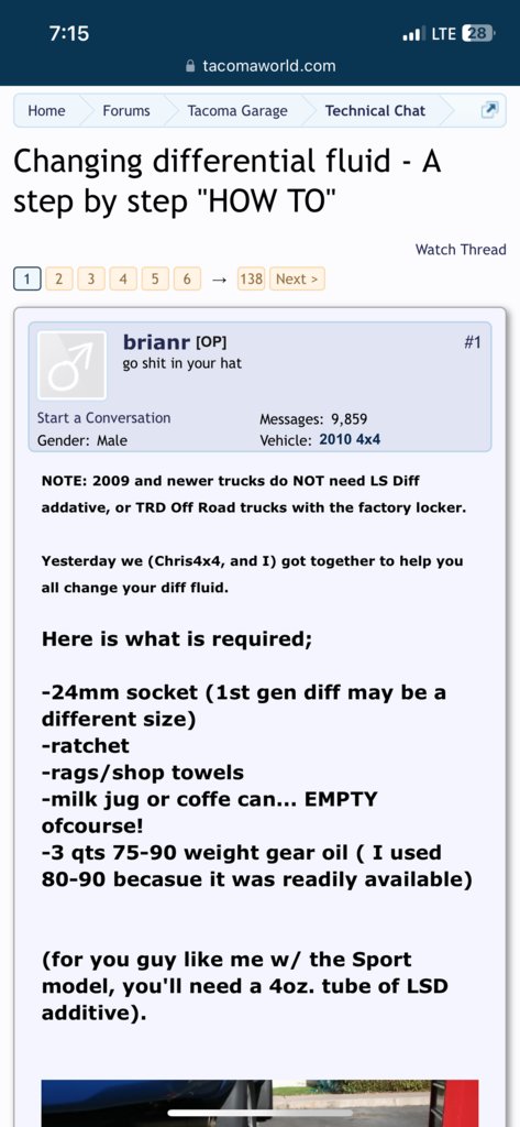

    @Steelhead Bum Thanks for the links. I'm good on the process how to do a drain and refill, but mainly my issue is confusion over the rear diff oil being refilled with or without additives. Further confused because of the various packages on the Taco, and moreso because everyone has a preference.
    Mobil isn't offered where I live unfortunately and have few options, getting jerks while driving so need to do this by tomorrow.
    I'm specifically needing to know if the Royal Purple Max Gear with friction modifier additive is safe to use based on the case's label I provided, do I need to add another type of additive or not, and do I need to buy a different oil altogether?

    My guy, it’s the first sentence of the link I attached lol. 09 and newer don’t need additional friction modifiers like the 05-08 w/ lsd. Just buy a 75-90 or 80-90 synthetic. Most synthetic gear oils nowadays contain lsd additives. Mobile and valvoline both do and I have used both in my 13 sport with no issues. Royal purple with lsd additive will work just fine if that’s what you have. It’s not going to hurt anything. Running oil without friction modifiers in mechanical limited slips will damage. 09 and newer don’t have mechanical limited slip.

    @Steelhead Bum Dude lol, I'm sorry! What got me was the first sentence conflicted with the last sentence: "...w/ the Sport model you'll need a 4oz tube of LSD additive." And I have a TRD Sport, thus the confusion!

    No worries, definitely contradicting statements there.
    You’ll be good with the RP you mentioned above.
    Make sure to crack the fill plug loose first before removing the drain plug.
