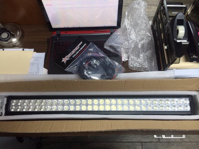

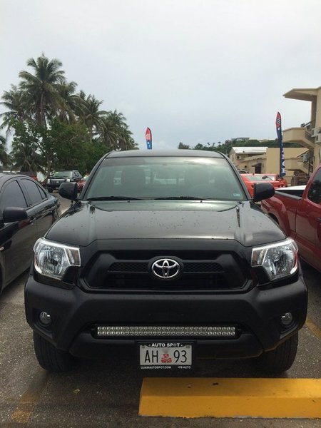

    Light bar came in today! Also, the rigid industries harness I ordered for it! The lens has a protective film over it im not gonna take it off until im done installing it. Here it is...

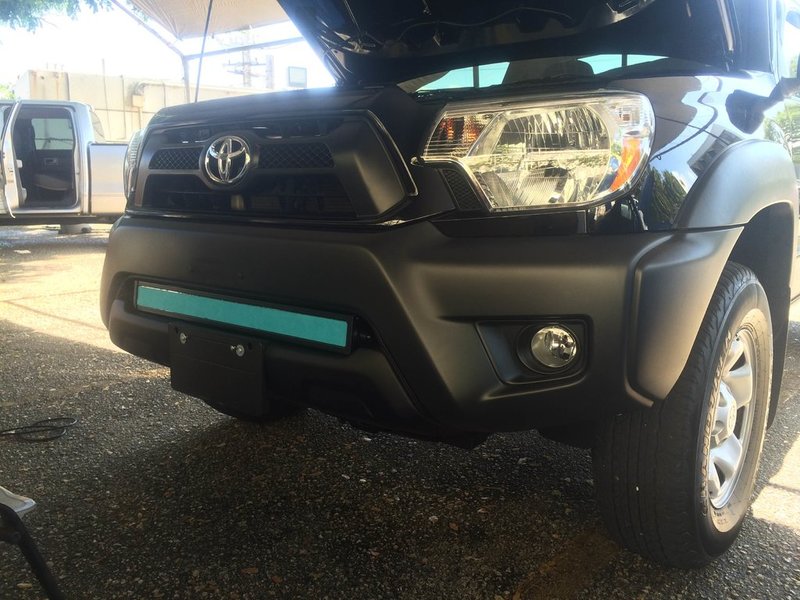

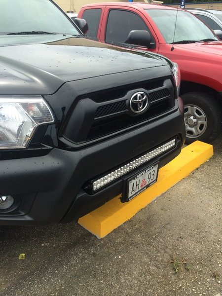

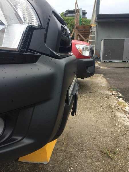

    Stayed up last night and cut out some of the lower grill so, the light bar can sit flush instead of it popping out. This morning I was able to test fit it and see how I needed to make the brackets to mount on the crash bar. I have the material just need to find the time to do it but, heres how its looking... I ended up putting tape over the lens because the protective film was coming off.

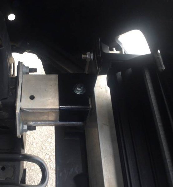

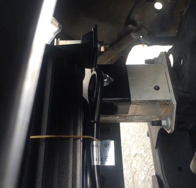

    Got to mount the light bar today. Made two "L" brackets from a strip of 1/4 steel plate I purchased at home depot. Painted them black and mounted them to the crash bar. Originally I was going to mount them by drilling holes into the crash bar but, there were already factory holes so, I decided to use them instead of making my own. *Before mounting I took the side caps off the bar and sealed it with clear silicone. Then after screwing it back together I sealed the outer part and lens area off as well*
    How the brackets look from above left and right side.

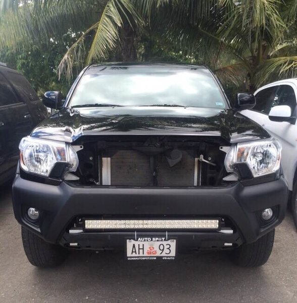

    Front view, took the grill off to make it easier to mount the bar. Also having the lower grill repainted to cover up the white parts of the plastic from when I trimmed it.

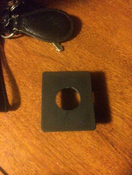

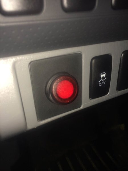

    Button that came with the rigid harness installed!

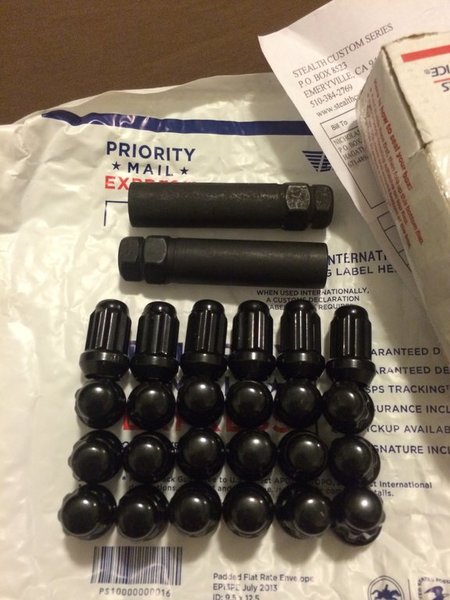

    Also, my SCS lug nuts came in today very pleased with the quality of the product. If you're looking for lugs for your wheels Vin @SCSPerformance is the man to go to!
