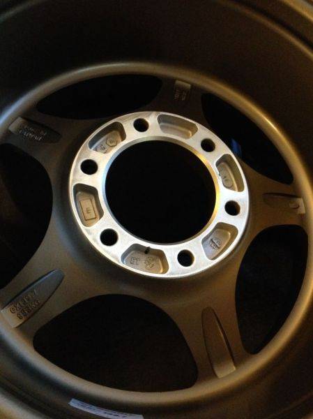

    check the back of the tires for those recesses (i'm pretty sure toyota wheels have them)...if they are there, you can go anywhere from .75" and up...
    if they are the 16x7 TRD off road wheels, it looks like they are 5.25" backspacing (http://www.tacomaworld.com/forum/wheels-tires/30754-wheel-specs.html). you'd be fine with .75"-1.25" to bring you in that 4-4.5" BS
    for example, i have pro comp 7089 17x8 right now that are 4.5" BS and i've run 285/70/17 for years and recently ran 305/70/17 and still had clearance (given i had aftermarket UCAs which offer a bit more clearance).
    so i'd say a 1" or 1.25" would be a good bet...you can usually find 1.25" spacers for sale frequently on here
