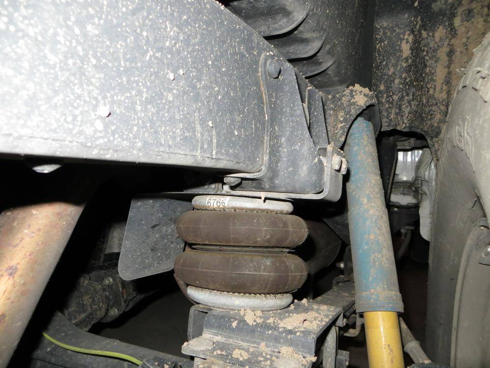

    How can this be possible?? I had them on my 2006 and it never bottomed even under load with 5 psi in them. Are you 100% sure that they are installed correctly?
    Do they look like this and the brackets are installed this way?

    My bags look exactly the same as posted above.
    The distance from the bottom of the bag to the top of the bag is the problem I think.
    There's not much room for the axle to move up before it hit the frame with the bags and brackets in the way.

    The pictures that I supplied are with 5 psi. I can honestly say that I NEVER bottomed them out with 5 PSI in them, I didn't think it was possible. Yeh, it would hit hard, but that was hitting on the bag, not bottoming or pinching the bag.
    As stated above, you MUST keep 5 psi minimum in there at all times. I cant imaging what would allow it to bottom. Did you run separate lines for each bag or did you TEE them? Not that it would cause it to bottom, but I had separate lines for mine.
    I always ran 5 psi even when towing my 16' boat, only a few times I ran 15 psi when I trailered a heavily loaded dual axle UHaul trailer or a pontoon. It about jars your kidneys without a load with 15psi.

    Sure your gauge is accurate? This is my bag with 5psi with stock springs and a leer shell on the truck. Doesn't bottom out and no harsh ride I put 17-20psi in when carrying my 550lb. camper which raises it to stock height.
