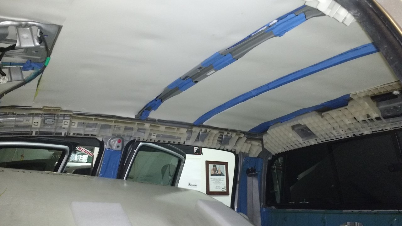

    Sweet install. I did my truck last year in the summer during a heat wave . I could only work in the garage from 6-9 am and then 8 pm till I got tired . The last night I went till 430 am to finish .
    On top of the deadner I also used 4mm closed cell foam . I also did the head liner . It took me a two weeks to stop speeding around because it was so quiet in the cab. IMG_20170621_204649643.jpg

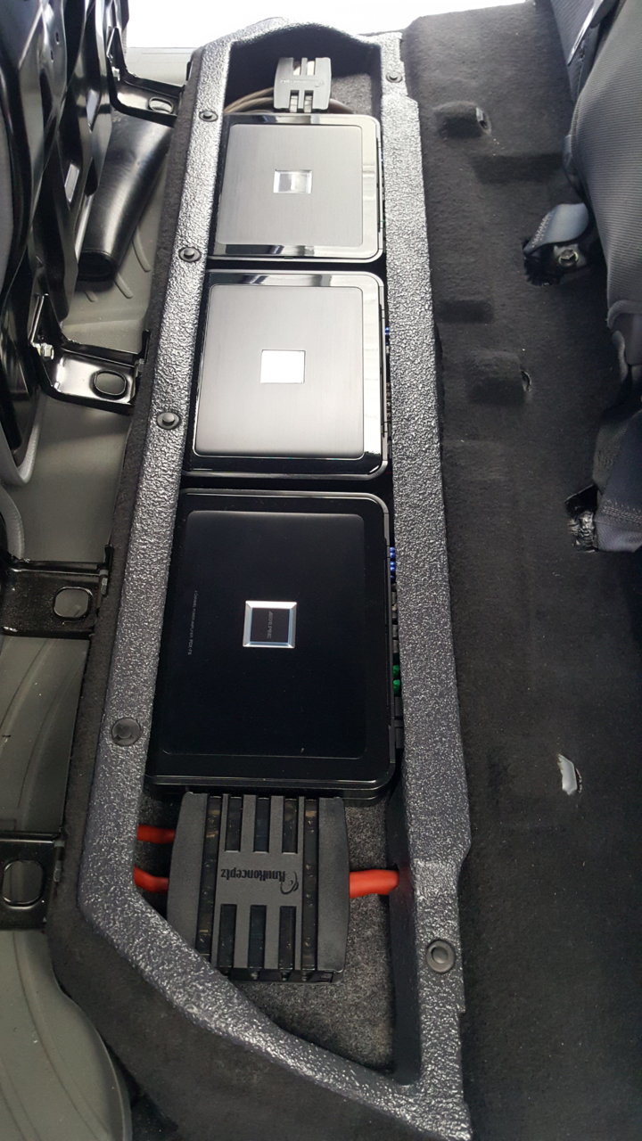

    20180617_143949.jpg I like them, in the old truck was running w7 10s, and that was too much for me , this is just right, finished the amp board trim ring.

    Nice job on the amp rack epiman - pretty slick!

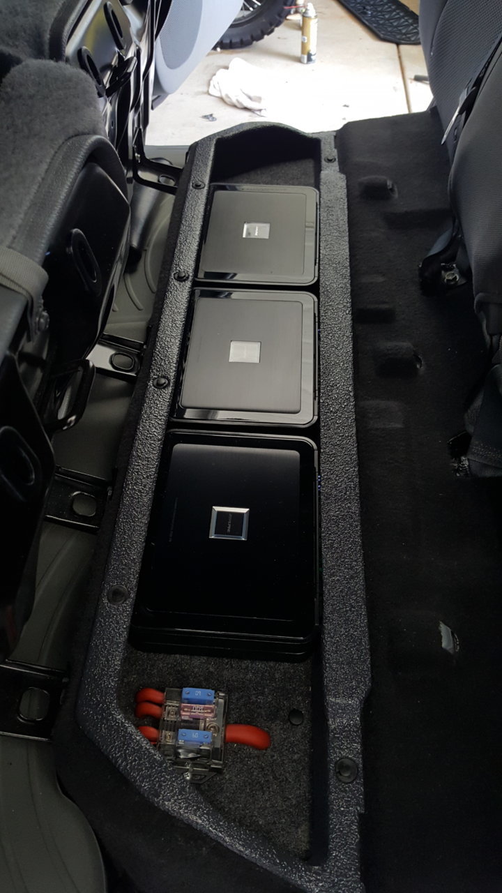

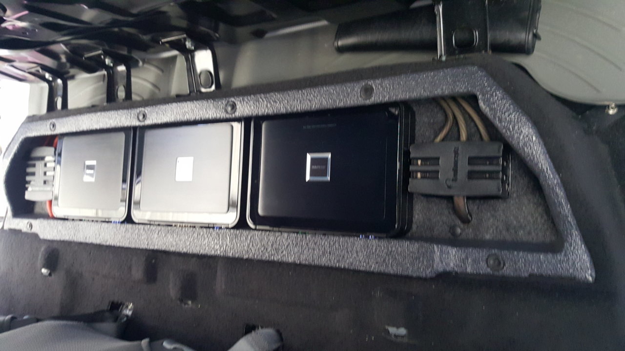

    20180624_141912.jpg Switched up the power and added a ground block, also I know it's not tunes, but got my lift done.and redid the trimming. 20180830_130502.jpg 20180624_141857.jpg
