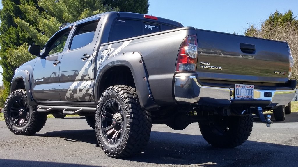

    Here is the 3" version of what you want.
    Toytec-1000
    Wheels & tires -1800
    This whole setup cost less than the 6" lift. And you end up with just as much ground clearance if not a little more.
