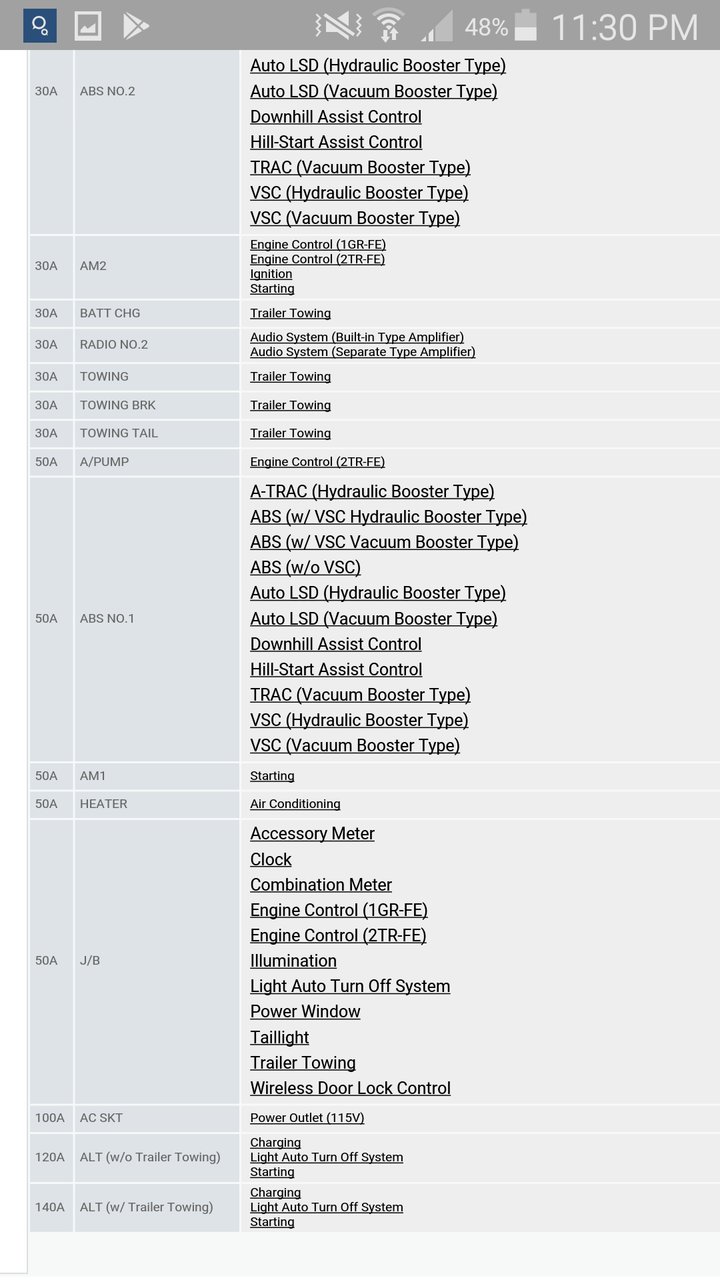

    The amp alt link is bolted from the bottom of the fuse box and will indeed not let you start the truck.
    Pop the top off the cover and link across with a screwdriver start the truck and get it to where your going to fix it

    Why do you keep cranking it expecting something to happen when you've got 3 blown fuses?! Replace them and then see where you're at.
    It's kinda backyard but you can pop the top off the alt fuse and mush the blown fuse ends together. If it starts you can replace it later

    I see you have to take the fuse box assembly apart to get to the 2 bolts connecting this fuse.
    Found this write up to do this! https://www.tacomaworld.com/threads...-box-battery-wire-replacement-upgrade.420450/
    Oh cool! Where did you find this list? So the ALT fuse does effect starting. Now to see if I can get this fuse box a part.

    That list is from the repair manual
