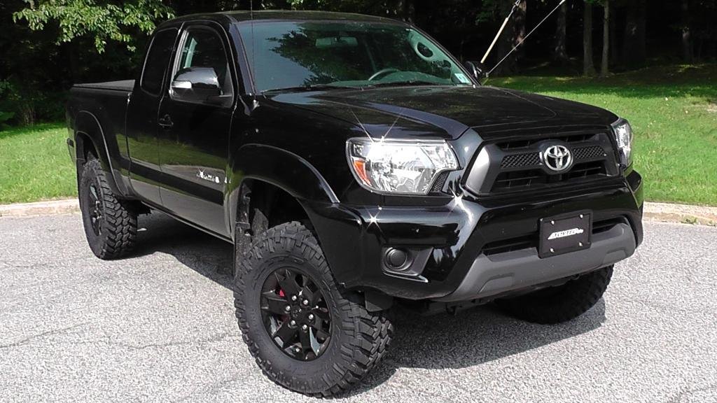

    The Nitto Trail Grappler 285X70R16 actual size is: Diameter of 31.89" and cross section of 11.5" (32X11.5X16). Are you thinking of most manufacturers 285X75R16's that are around 33.1" in diameter and 11.3" wide with rubbing issues? The Nitto's are a unique size.

    Do you hit your cab mount with that particular size nitto? Do you happen to know the back spacing of your oem wheel? I'm thinking about getting that size with my 3" lift but I really want to avoid any frame cutting. Thanks man!

    No worries, no rubbing, even with the mud flaps! The tires did rub the UCA's... but barely, I did go to BORA's .75" spacer to take care of that and with the spacers, no rubbing at all and I have all of the mud flaps on!

    Your welcome! Your truck looks great, like your bull bar too, I think I am going for one. Getting ready to put the new PA 2" body lift in mine, I think I am going with Mickey Thompson MTZ's 33x12.5R16. Ordered up the 1.25" Bora spacers, moving the .75" spacers to the back.
